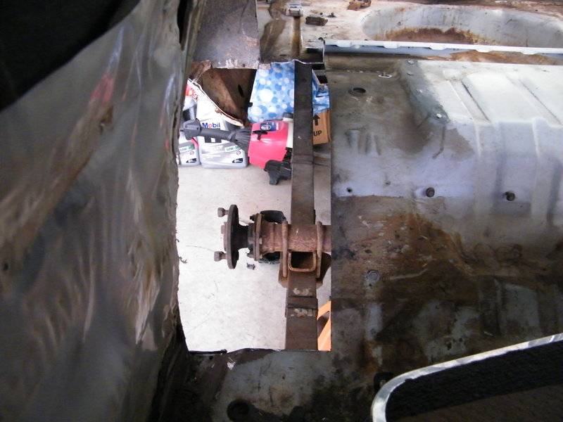

I've made very little progress, but some is better than none. You can see from comparing the first two photos to the third, fourth, and fifth photos that I opened up the cuts for the tubs a little larger. I originally planned on moving the original cut out tub in to the frame rail and just filling in between. Since then I've decided to create my own tubs.

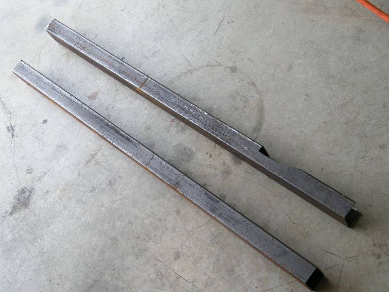

I bought the rectangle tubing for turning into sub-frame connectors. I've already cut both of them out. I plan to paint them today, except the last 4" on each end and where they go inside the car; I notched the floor already. Getting the connectors in will allow me to tie my ladder bar crossmember into them so I'm hoping to have the rear suspension done within the next month, as long as I can keep myself motivated.

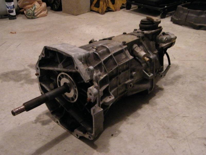

Score; check out what I picked up a few hours ago Northeast of Indianapolis. Here's what the ad read:
I have a 6 speed transmission and bellhousing from a 1996 dodge viper GTS.
I can't believe someone didn't get it before I did. The ad had been posted since 4 October.
I was going to hold out for a Passon 5-speed, but I couldn't pass up the deal. Time to start looking for another Lakewood to adapt it to an RB.
