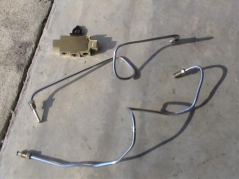

The following is a pictorial of how I cleaned up a proportional valve. This is for informational purposes only and if you elect to do something similar to this, you're on your own and I take no responsibility for your results (I hang around too many lawyers....LOL). This is a typical junk yard score or your 35+ year old valve:
I cut the excess tubing off with a set of side cutters or dykes leaving about an inch or so of the old tubing. I do this for a couple of reasons: 1. It provides a cheap source of good plugs to keep the trash and mud daubers out. 2. It allows me to get a 6-point socket or closed-end wrench over those fittings. You're gonna want that because most of these are in there really tight where even a tubing wrench won't move em. 3. It saves rounding off the fittings that could otherwise be cleaned up and re-used if need be. Here it is fresh from the bead blaster and tubing lines cut as described:

Is this an aftermarket kit for switching from front drums to discs? Are those lines stainless?
Nice cleanup lgjhn!
No it's not a aftermarket kit. It's same valve as for drum brakes. I was going to install a adjusting valve but after driving the car I found I didn't need it. Yes they are stainless lines.
