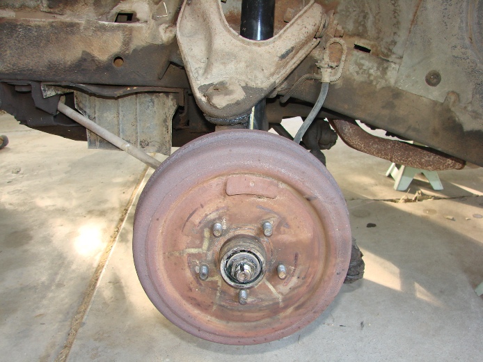

Lifted the front end and pulled the tires. Found that the Brick has 10" drums.....Gene is going to use the steering knuckles on his Cuda when we actually start working on it.

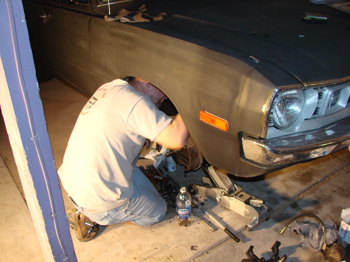

Here is Gene working on removing the drum setup on the passenger side.

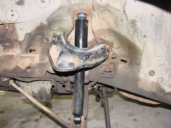

If you are faint of heart, speed past the next pic. Found a big crack while working on the passenger side. Think we can fix it?
I will skip the normal details as there has been other posts about removing the drum brake setup.

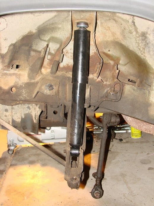

Here is the empty wheel well.

Using a 5 inch bolt, 2 sockets, 2 washes and a nut, I was able to get the upper control arm bushings "pressed" in.
Things were going great until the UCA slipped and hit me right in the beanbag........which my friend caught on camera.
After a little persuading, the UCA went right in, was able to get the cam adjustment bolts in pretty quickly.

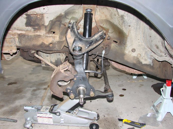

Installed the upper ball joint and then assembled the knuckle/adapter/lower ball joint assemble with the brand new grade 10 hardware. Gene showed up and started to work on getting bearings packet (grease gun sucked big time) and we hung drivers side first.
Mounted the caliper and setup the brake line. Had to take a file to the mounting tab for the hose, as the hose end was bigger than the drum brake one. Bolted it all up, set to torque and then checked clearances. Wheel will move max with no binding, no grinding, and nice and tight.
