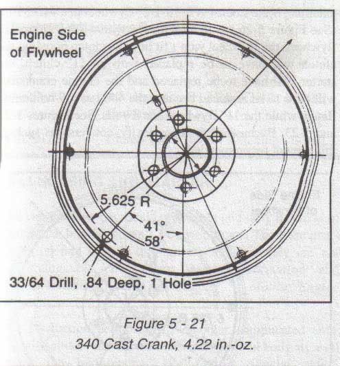

Here's the diagram for drilling a neutral balance flywheel. Forgot all about this, I just went straight to part numbers since you asked. Good catch caferacerx.
I forgot about this one too...

If you have a 360 you need this drill diagram
The one posted above is for a cast crank 340 and VERY different.
