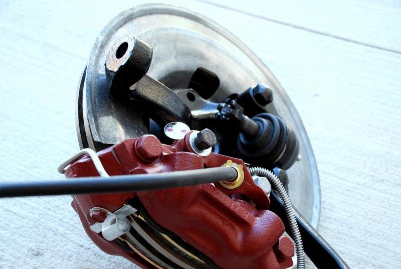

NEEDED badly kelsey hayes part #s for rubber brake lines
chubsgts
Dec 20, 2010
433
0
mi
i really need a good number for the front rubber lines no one seems to have any ideal what im talking about at the stores no listings and ive called some of the bigger brake swap companys and there no help can any one please give me a good number on lines they know work
and i could use a pic of how the hose retaining braket mounts on rear of spindel to so i can fig out the direction
thanks guys

Napa hose number for the 4 piston Kelsey hays calipers is 36654. Same hose for both wheels. I just bought some and they were correct.
yea thats the lines i got they kept listing the wrong style for the kelsey hayes stuff and the one set shown was about 2" to short
