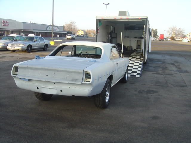

last pic is Tim Herren's track burner 68 valiant at speed. pretty sure he's got a b-body rear in his and he's running 18x9 cobra R wheels.
props to Herren for the pic, it's one of my favorites!

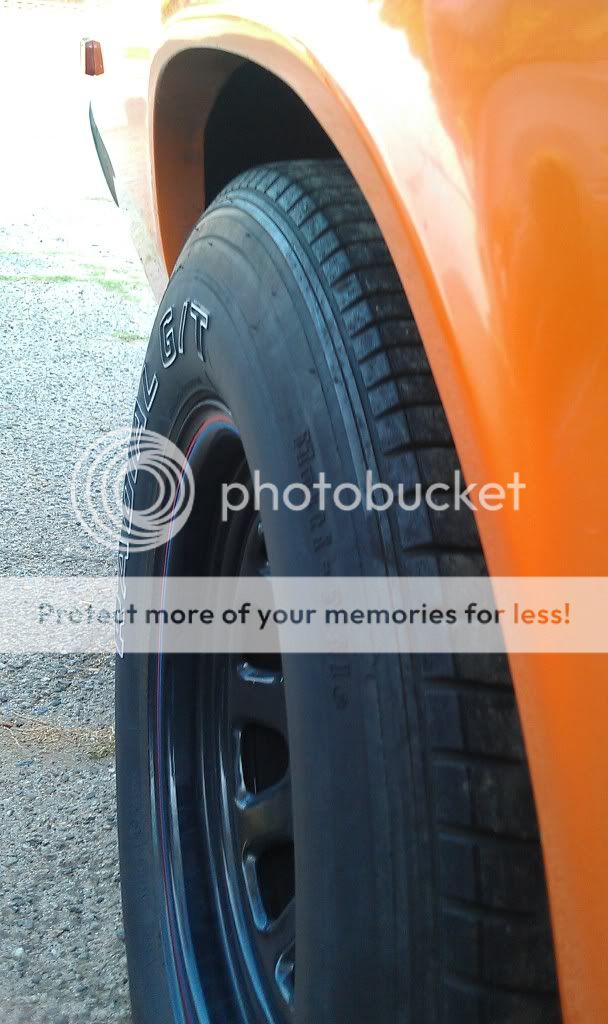

Heres a couple more... 15x8 rims with 5 inches of backspace
I know not the best pics but they are stock ralleys with 235 60 14s and rolled 1/4 lips on a B body 8 3/4.

B body rear 255/60/15 on a 15-8 with about 4 in offset Ya I know there for looks (traction bars)
B-body Dana, 10" rims w/6.5 backspacing, 305 50 15R BFGs, 3/4" spring relocation, no tubbing.
inboard springs, "b" dana, 15"x9" with 7"bs and 29"x10.5"W's. i now have 31"x10.5"W's in the wheelhouse.
Did you have it mini tubbed in that picture? Did you have to shorten the axle/housing or just make up for it with wheel spacing? Ever run street tires on it, or just slicks? Also how far inboard did you move the springs? That stance is just sick!
