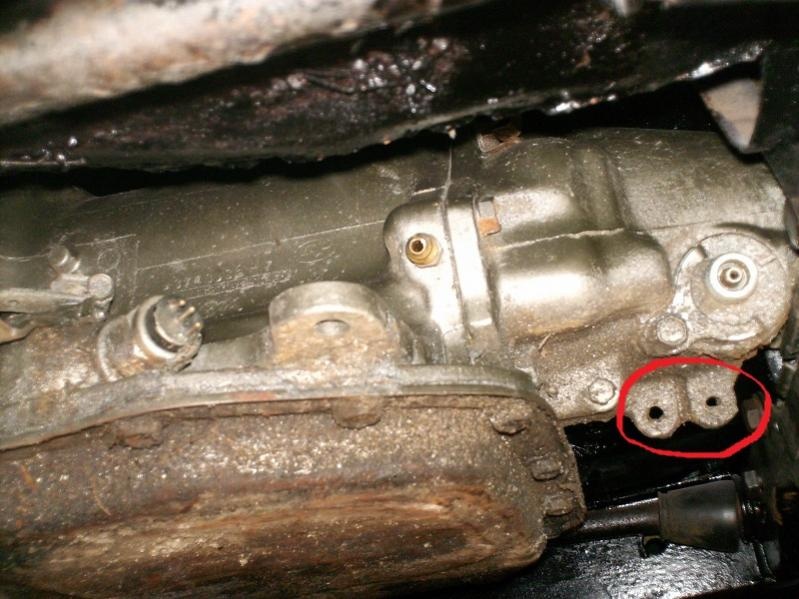

I didn't realize this but got lucky---when I converted from my 904 to 727 in my 67, the 77 trans I got out of a B200 van did have the correct mounting boss
Here's a poor photo of one, not mine---you can see the two bolt holes on the bottom for this bracket. My 67 shop manual diagram looks essentially the same as the one you posted
Thanks guys, gotta wait and see what "nite moves" wants to do....I can clearly see the 2 hole mount boss, we would also need the mount for it.

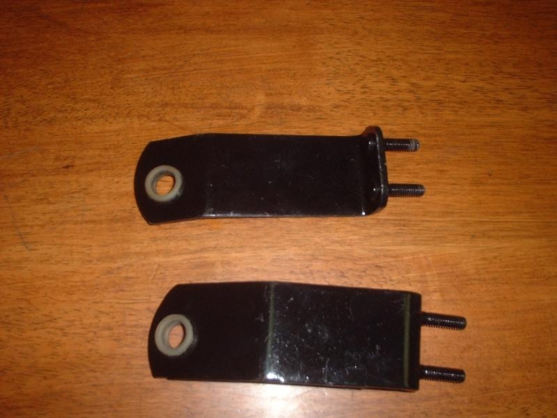

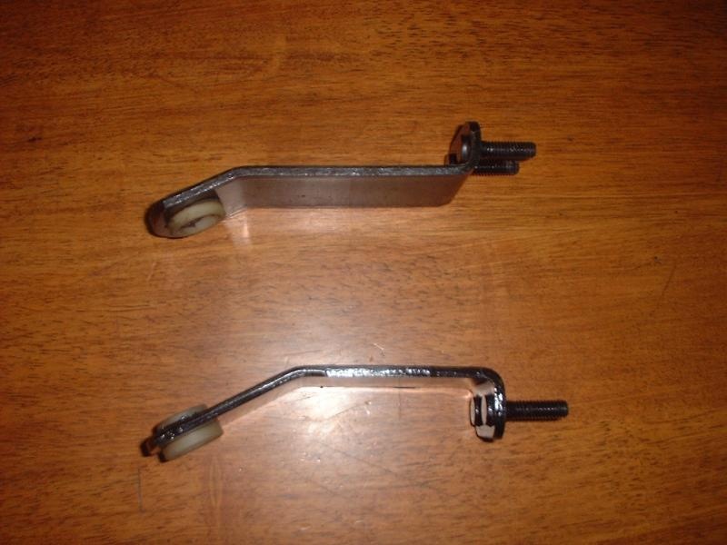

The mounting bracket for 19A is different for the 904 to 727. The bend on the end where the studs are is bent in the opposite dirrection. The only reason I could see why is because those tabs are lower on the 727 because of the tailshaft diameter . I have both if pictures are needed. and both trans missions out for pics. Let me know Steve
Any pics would help, "nite moves" has 3 904's and none of them have the 2hole boss and we are missing the mount that goes to the boss. Really got is scratchin our heads!! Oh if you have the vertical rod(#17) can you get dimensions?? Thanks a ton!!

I hvae to go pick up my parts for my skid loader when the wife gets out of the shower . When I get back I will take some pics

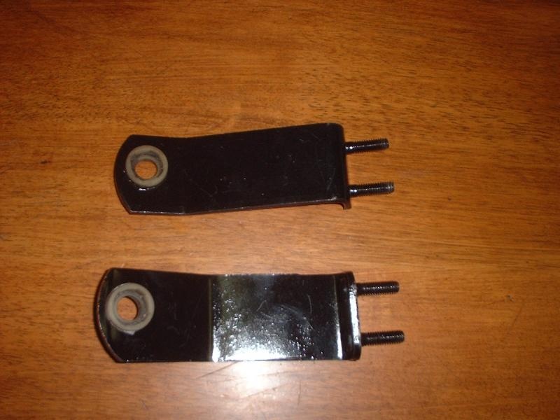

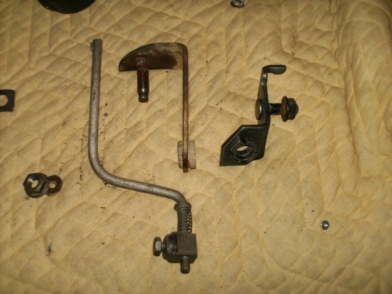

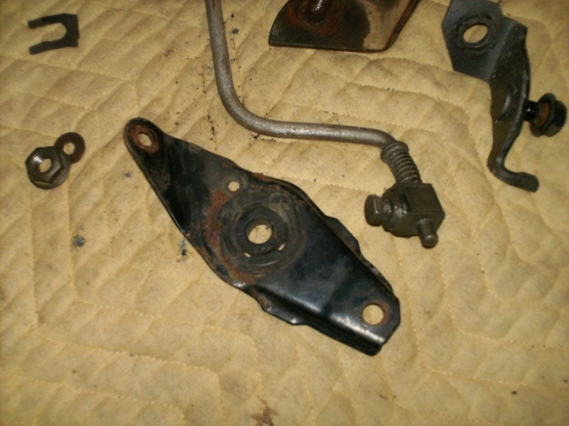

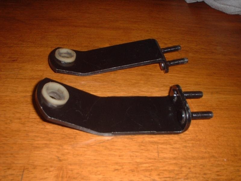

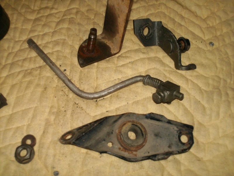

Here are a few pics. I think Steve and i had 2 few beers...YAH! i said few. linkages tranny pics and brackets........i think i found the 2 holes:banghead::violent1:
Thanks for the pics, see the circled parts in my pics, the one pic is of the 2 brackets that Ed has...NFG, cuz the way they are shaped and mount, it puts the rod horizontal. The next pic has a rod with a spring on it, what is that for?? Ed measure the 2 holes center to center and post the dimensions. OMM are you able to measure the bolt spacing on the brackets??

I have to say...none of those parts look to be the same on Oz shifters except for the 19A part.
All our Oz shifter parts are VERY similar to the slapstik in my 70 challenger.
......Edd u need the bracket omm has a shot of on the table................OK, the 3 pieces in the last pic.of urs Steve...left 2 right...........bottom rod 4 the 73 up kd linkage...not sure on which body though.....next=late B body bracket that bolts 2 the trans 2 support the cross shaft coming from the frame on a column shift car......last piece=used on all bodies and engine combinations,same purpose as #2, but differ slightly 4 all combos........none of these parts r 4 consol linkage........kim........
Thanks Kim.........I kind of figured that. The pic of the brackets is what i need........BUT what one? There close except the mount aspect. I need the one for a 904.
The stud spacing is the same on both. Center to center is 1 1/8. . I am pretty sure the longer one of the two is the 904 which would be the lower one.
The tail shaft housing is smaller on the 904 and those two tabs on the trans are higher and farther away . This puts them at a different location then the 727. I have several if you need one Just pay shipping.
That 73 sunroof Duster I just sold Is what really brought my attention to This. It came witha a 318 904 from the factory with a floor shift. They installed a 360 727and the shifting was screwed. I put it on the lift and replace this part and the rod going from the shift linkage to the trans and the trans lever. The lever was also wrong because the 727 came from who a knows what column shift car.I have a large collection of linkage gathered over the years . I went through the bins and just pulled what fit. It then workrd fine.
I am not sure on the correct lever and rod but with measurement am sure I could help.. I think I have a 68 barracuda floor sectoion here from a 904 car with the rod on. If not I can put my neighbors car on the lift when its free and match them up. He has a 904 floor shift 68 barracuda.
Like I said for just a couple of parts I will give them to you for just the shipping. I have more then I will ever use and allways bring more home. I would just be glad to help. Let me know what you want to do . I come and go from this computor all the time so I may not respond right away. Steve
