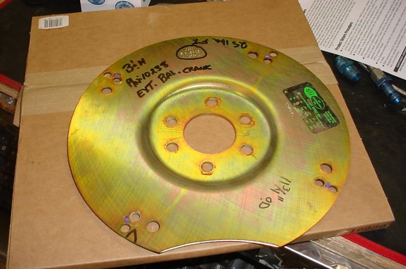

B&M has spoken:
Brad,
Yeah that is definitely on backwards.

Not getting any sleep last night paid off. Easy fix at this time. Thanks guysrayer:
The flex plate should be marked, "Engine side".
Bill S.
You can only install all 6 bolts when it is on correct because the bolts are offset. Therefore it is not possible to install it backwards.
