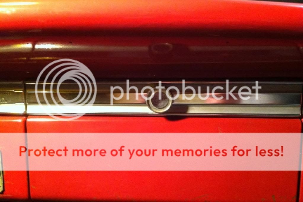

I won a small victory on the interior by picking up a phillips-head bolt that fit my glove box knob:

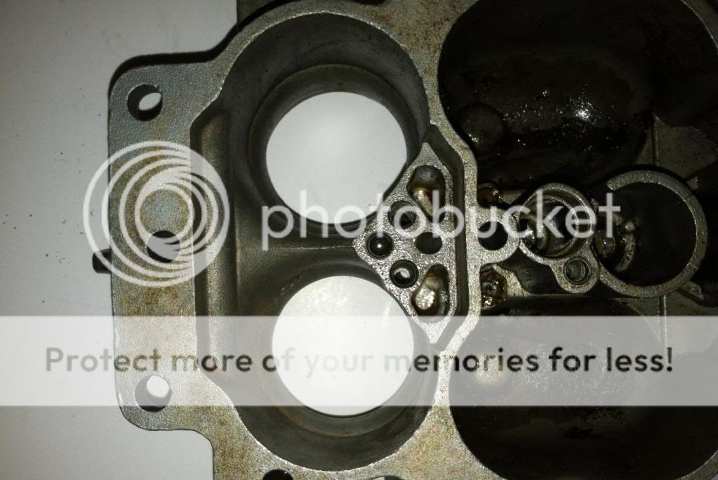

Last weekend rebuilt the carb which was desperately needed as seen in these photos:
Rust soup, and some more rust soup...
It's hard to make out but if you look in the bowls to the right of the photo, you can pick out the nasty, rusty gasoline sludge that was in this carb.

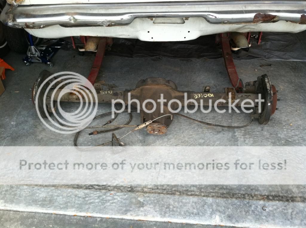

As stated above, this is a slow, go-as-I-can-afford build. Two months ago I purchased my first big piece of the upgrade. It's an 8.8" 31-spline axle out of a '98 Ford Explorer. Disc brakes!

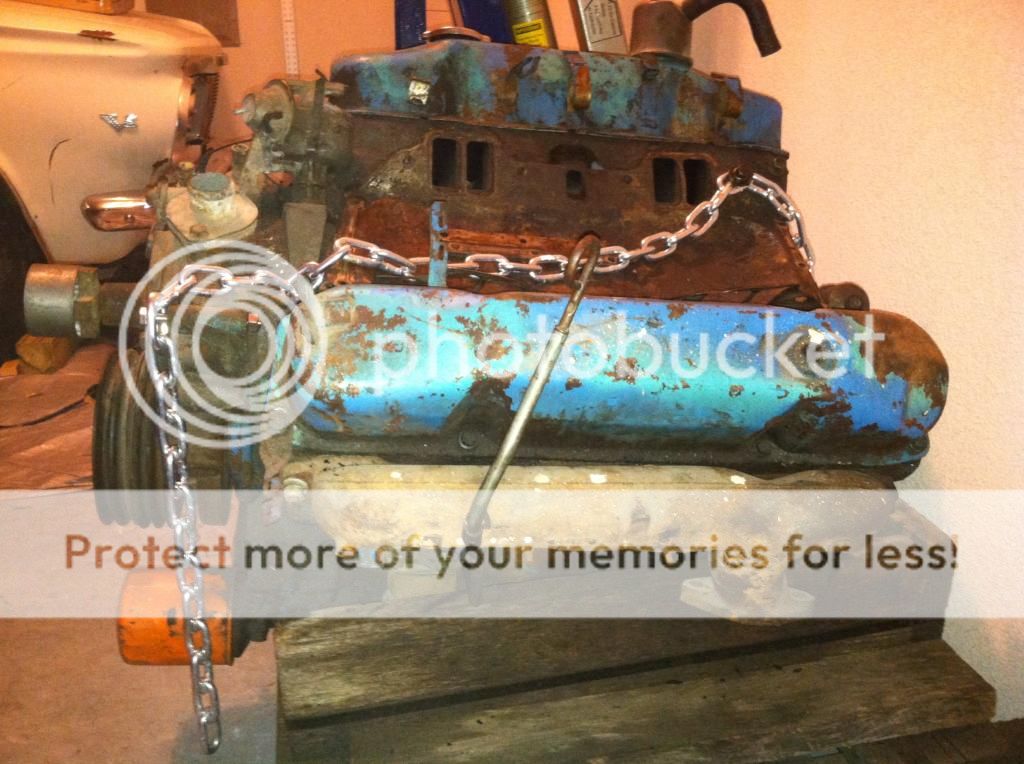

Up next is the 383 I bought...well at least I thought it was a 383. Turns out that externally, 383's and 400 BB's are 100% identical. It wasn't until I got the engine out of the cramped storage it was in, and into my garage that I was able to see the casting numbers and realize that the "383" the PO sold me was actually a 400. Oh well, hoping I can do something with this:
