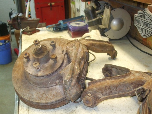

He has a front wheel pictured so that is the special made stud that looks like this.
This is a problem child. The issue is the rotors are two peice assemblies instead of the one peice rotor most are used to on the older cars. You have the rotor and then the hub. The diameter of the stud has to be maintained all the way through the hub because the knurl attaches the rotor an hub assembly. Any slop and trouble will be in the cards.

You can see how much threads are on these studs and 1/4" spacer shouldn't give the problem as shown.

Thanks Ok, i understand now. I see what you mean on his pics, that wheel looks a lot further out then a 1/4". The nose in the bearing area looks really short?
I just went and measure the stud length. There is one inch of wheel stud sticking out of the hub. There is a very slight shoulder sticking out past the hub.

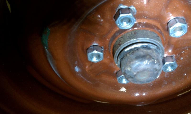

Wow, now you guys got me wondering. The spacers are 1/4", I had them custom made. They fit flush all the way to the mounting surface... They aren't getting hung up on anything. The wheels I believe are Wheel Vintiques ( don't Know for sure because the customer supplied them). I also ran into an issue with the rear also. when this rear-end housing was manufactured back in 1970, the leaf spring perches were welded on offset to one side . With the factory wheels and tires, this would not be a problem. I would guess that you wouldn't even notice. But while trying to fill up the wheel wells with a wider wheel/ tire, one side was 3/8" from rubbing on the leaf spring while the other side... maybe you could slide a couple or 3 bussiness cards in there. Short story long, I'm also running a 1/4" spacer on the rear and I have the same short stud problem there. When I go back to the shop on monday I will take a pic of the rear with-out the spacer so you can see how the stud / lugnut looks.

I measured the front stud in a complete assembly and I have one inch of stud sticking out. The wheel you show is a correct OEM wheel or is it a custom made wheel?
