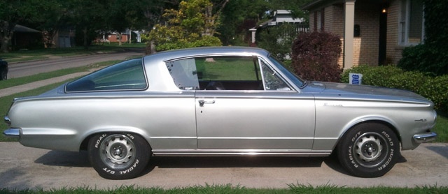

Thanks everyone. I will post more pics soon. I did not post a pic of the front stance with the motor in. Will do that next.
Looks great, I will be doing the same to mine as soon as I'm done with a project I'm doing for a buddy!!! I can't wait, its been 10 years long years since I have driven her!!
mlmmopar,
Thanks, and I know what you mean! I bought this car back in '89 or so. Stored it everywhere, worked on it when I could. This is the second go around. It has the original paint scheme but has been repainted maybe 10 years ago. I put a 340 sixpack in it, front discs, then the 5 speed. It's an original 4 speed car.
