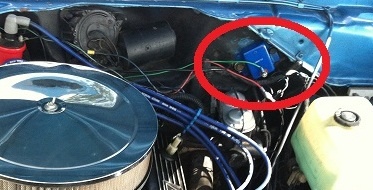

I orig had issue with dim headlights that would brighten as I accelerated… switched to the blue "racing" regulator (see pic). Could that be an issue? Yea, I know... I gotta clean up and secure those wires still.

… switched to the blue "racing" regulator (see pic). Could that be an issue? .
Make DAMN sure that thing is grounded. Remove it and (if used) electronic ignition box, and scrape clean behind the mount ears, as well as around the mounting holes on the firewall. Mount using star washers. It does not hurt to make a "daisy chain" ground of no12 were, hook between one bolt on the regulator, and one on the ignition, and run to the body, and finally to the engine.

Is this the regulator you bought?
Voltage Regulator, 13.5 V Constant Output, Race Only, Chrysler, Dodge, Plymouth, Part Number: DCC-3690731
Just guessing, but not too many blue ones out there. The two words right before "Chrysler" in the description would put me off in search of a different one.

Any good or bads in regards to the blue regulator?
Has kept my headlights from dimming due to idle but heard it can be hard on battery/alternator?
Thanks for the article! Remember seeing that once but never saved it.
This thing has generated a LOT of controversy because of the wording, year after year, in the MP catalog, which has (had?) a disclaimer about "race only."
As long as it's properly grounded it should work just fine. Check your running battery voltage after it has normalized. After starting, warming up, and getting the battery fully charged, your voltage, running, at the battery, should be 13.8--14.2 volts, in no case lower than 13.5, and not higher than 14.5
This is also one reason that I'm always preaching to "check voltage drop" on the ignition run buss. If there is drop in that circuit, the regulator will "see" lower battery voltage, and will ramp up charging voltage to compensate. That is, if the regulator is properly regulating to say, 14, the drop in the harness, whatever that figure is, will be added to the battery running voltage.
