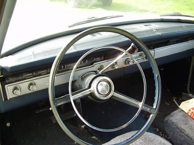

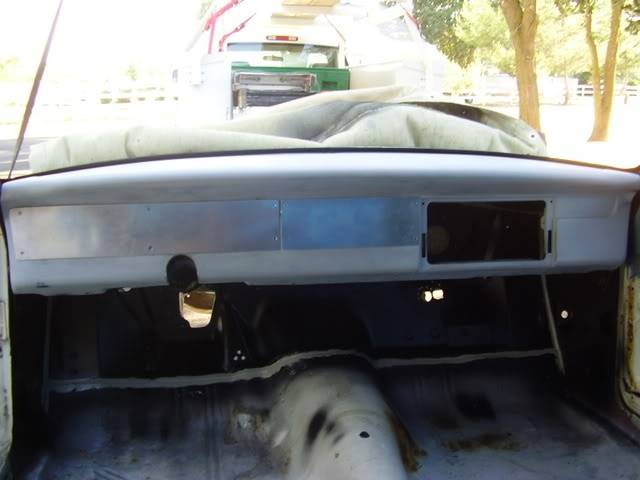

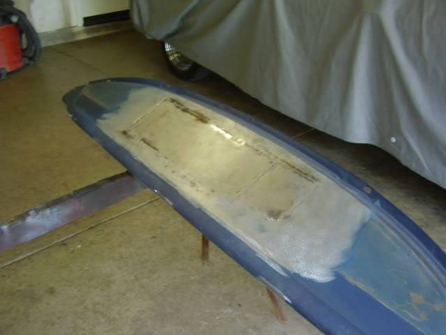

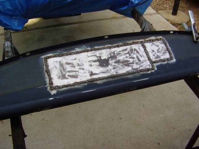

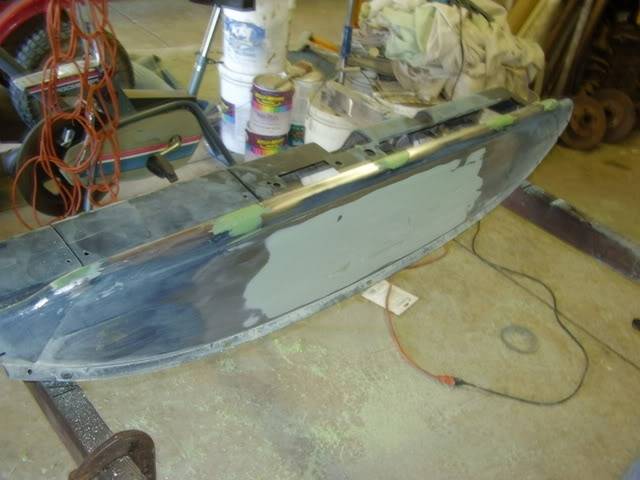

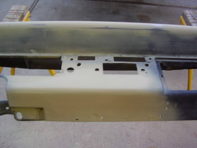

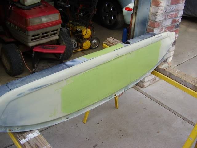

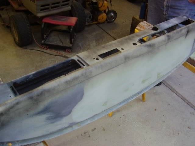

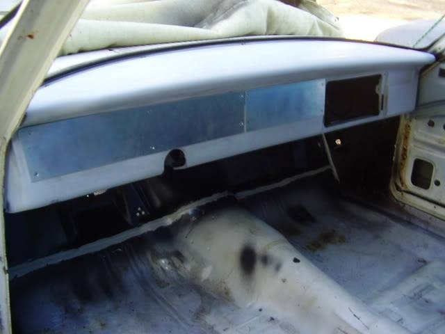

I just thought I'd post some pics of the dash in my 66. Some people might not like the fact that I cut it up, but I think it turned out quite nice. I still need to add the gauges and toggle switches obviously. What do ya think?
I didn't have a big enough piece of sheet metal, so I had to use 2 pieces.
I don't smoke

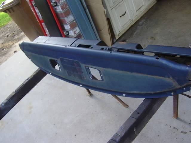

Underside:
Final product:
From this:
To this:

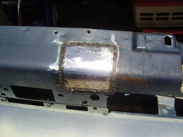

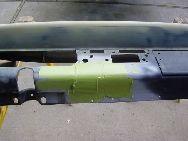

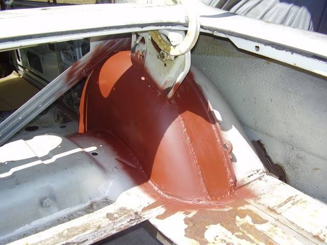

I decided to go with two pieces of aluminum instead of 1 just in case I have to change or do any work to the toggle switch panel on the right, I don't have to take the whole thing down. I also welded up the holes on the right side of the dash and the glove box to get rid of the trim pieces for a cleaner look

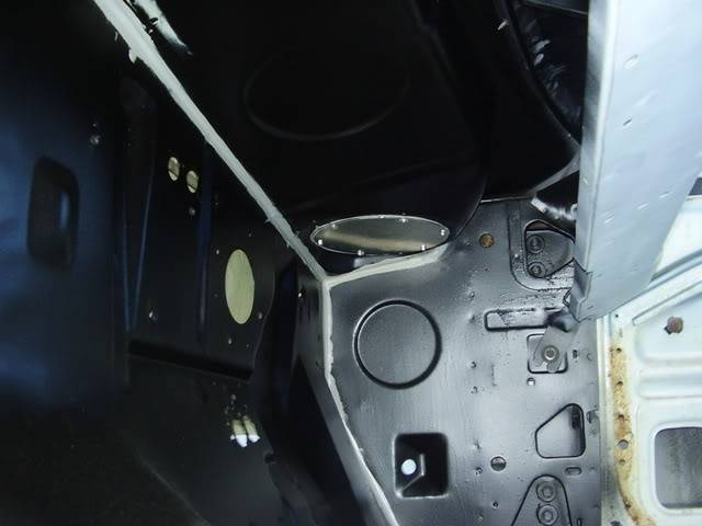

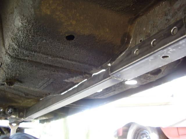

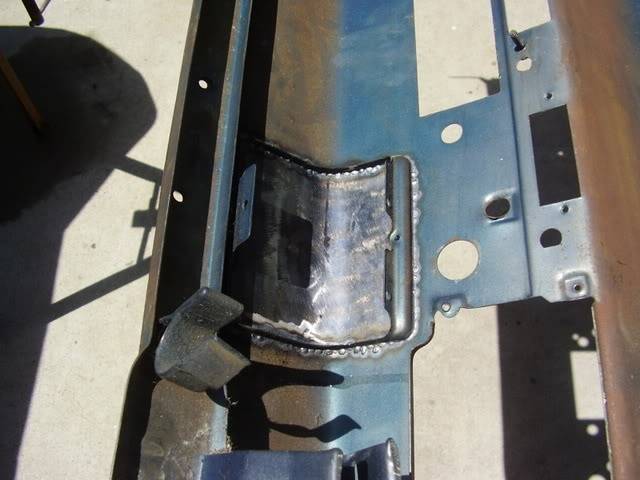

Here are some extra random shots of some other work that was done while the dash was out:
BEFORE (notice the block off plates for where the wipers go):
AFTER:
no more wiper motor bracket. Also made a couple block off plates for where the cowl vent boxes hook to. Painted it with Zero-Rust.

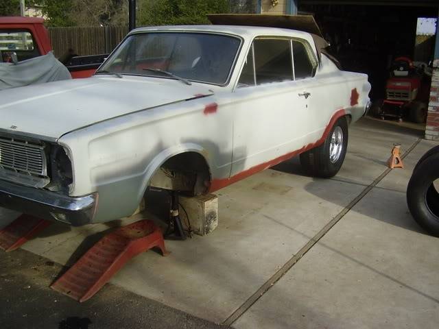

Thanks for the kind words guys. THis is the first time I've ever done this type of work. My dad and I kind of got this car as one last father son project. It'll be a street strip hotrod with a stroker big block. We're shooting for high 10s on motor.
Fstfish66: We got rid of the vents because we'll have no need for them. In fact, the only reason we redid the dash at this point is because we're starting to install the cage and once the cage is in, the dash will be in for good. The combo will be 470 or 512 (not decided yet), 727, Dana 60 w/ 4.10, 315/60/15 drag radials.

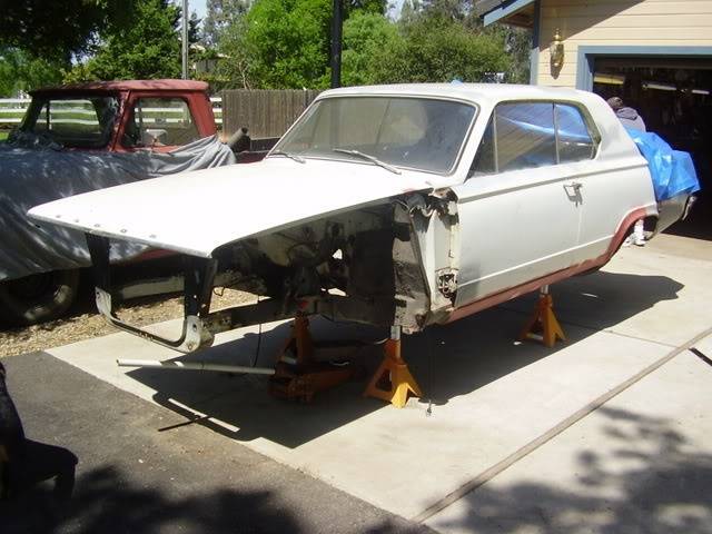

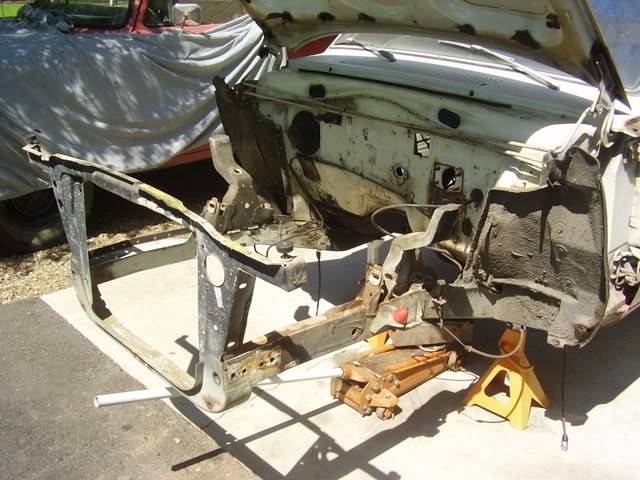

Here are some other random pics of the build:

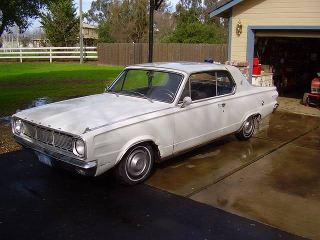

This is what it looked like when I bought it last Feb. for $400.

:thumbup: Congrat's.First time you do this kind of work?Well Done!Looks preety good.What kind of welding did you used?
I guess I'm a purist, but I like it! It's a nice clean look, appropriate for a race car with a roll cage and all that.
My only question is why didn't you fill in the indented area to the right of the glove box for a complete smooth look?
Thanks again guys. I get a ton of ideas off sites like this one, so I thought I should probably post some pics in case someone might want a few ideas to use on their own ride.
I thought about it. But when the glove box door is on, it looks really cool with just the trim holes welded up the way it is. I also thought about running the aluminum all the way across the dash, but I thought that would be overkill.
I've just got a little 135 amp Lincoln MIG. It may be small, but it does everything I need it to. I like using 75/25 mixed gas and 0.025" wire.

Underside:

From this:
To this:
