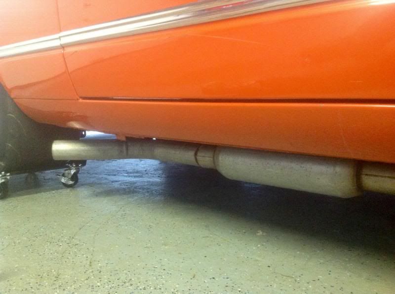

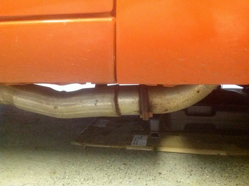

Exhaust:
You heard the car in the vid. This car will NEVER pass inspection with side exhausts. I am not even sure if they are actual mufflers. They might just be resonators. This car sounds like a full blown drag car. Also, due to the fenderwell headers I have exactly 3 inches of ground clearance from lowest point of header and ground. Should I put on some kind of sheild? Also, my turning radius is limited.
I found a shop to do the exhaust. I was thinking x-pipe with Dynamax Utlra Flo's and dual exhaust out back with down turn pipes. This one is important so I would like some input here please. This is the one thing I have to outsource for sure.
The exhaust looks higher in the picks as the car is on dollies at the moment.

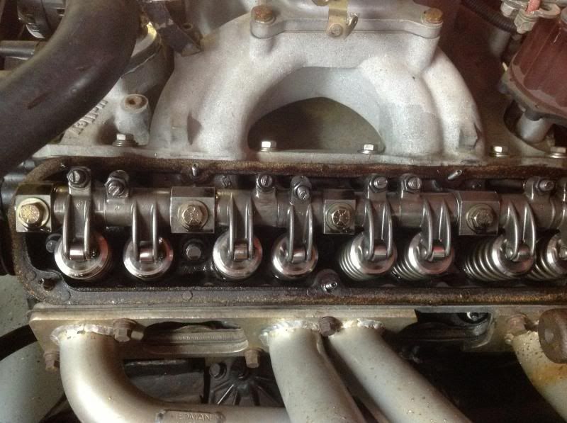

I see what appears to be header flanges sandwiched between the headers and heads. W2 heads maybe?
You are correct. Removed the valve covers to discover this... Yes. I am replacing the gaskets. I still have not heard back from the engine builder so specs are still a bit of a mystery at this point.
