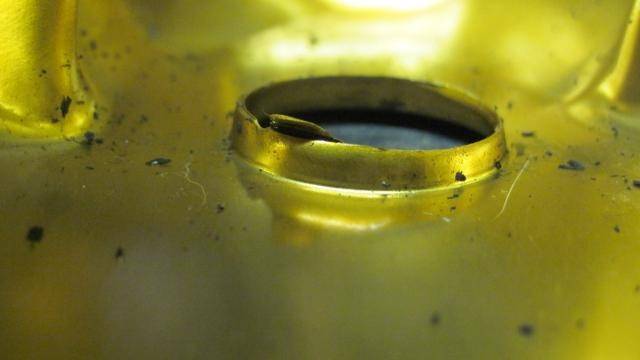

While doing my initial inspection on a pair of Moroso gold valve covers this evening ...
I was shocked to turn them upside down and see this.
Yep, little flaps of metal on the inside that weren't fully cut away when it was stamped ...
Especially since these valve covers were designed for race applications, this is disturbing to say the least. Since it was on BOTH of them in exactly the same spot too, that leads me to believe these aren't the only ones out there with this defect. If you own a pair of these valve covers, I'd pull them off and have a look.
The little tab will just come off with a few bends back and forth, which is a good thing when you go to remove it ... but it could also be a terrible thing if it falls off on its own the next time you're adding a quart of oil.
Beware FABO members! Share this with your friends if they happen to have a pair of these under the hood.

Leanna,
First off, I have no excuse for the little tab. The tool must have had a nick and some got done like that and we missed them. Although we try hard to be perfect, we are not.
However, We have not gold anodized valve covers since 2008. That means these are at least five years old, and look like they have served their previous owners well. They look like they have had a fairly hard life, but are still good enough for you to be replating.
We do not have any valve covers in stock that have this issue. And I guarantee there are no new sets in the field that do either.
I am glad you caught it and it won’t be a future issue for your customer.
Lastly, since we are “friends” on facebook, and facebook is how you let me know about it, it would have been polite to just send me a private message or email before you posted this on “every Mopar page I’m on”. I could have assured you this is not an existing or ongoing issue.
If you would, please let me know what other forums you have posted on so I may respond to those also.

Rick, I appreciate you stepping up with your reply, and I'm sure everyone else does too.
Though you suggest it would have been polite to have advised you of this privately, I believe the public service aspect totally outweighed any personal embarrassment to the company that might have been caused ... especially since my reputation in the industry is as a parts restorer rather than a parts seller. The fact they're no longer even made makes my announcement even more important because as time goes on, more and more people are going to want to get them restored just like they do with HP273 Commandos.
Would you be able to contact every purchaser who might still have a set of these valve covers, or be able to track down individuals who may have purchased them used? Neither do I ... so I chose what I saw to be the best, fastest and most widespread alert to the people who it might impact. If I was wrong then I was wrong, and I apologize to Moroso for it, but I still think the needs of the many outweighed the needs of the one.
I'm glad I caught it too. It's not the first time either -- ask RumbleFish360 about his brand new Permacool oil filter relocation kit for instance, or those countless Magnum valve cover owners who found loose baffle screws like I did -- and in my business I seriously doubt it will be the last. The way I see it, I am the 'last line of defense,' and once my guys put my restorations on their motor I want them to continue to rest assured that everything will be right.
Leanna,
As I replied to Aaron on your post on facebook, all I asked is if you could have contacted me first. Then you could have posted the pictures publicly. I don't disagree that this should be public, but it should have started privately. Like I said, I should not really even need to be posting. You could have gotten the info from me and posted it with your pics, and warned everybody correctly instead of the way you did.
Rick
Regardless of whether these are new production pieces or not is beside the point. The defect exists and people need to be aware of it if they own a pair.
You might disagree, but I think it's better they find out now this way instead of at the machine shop after damage has already been done .........

Why are you so concerned that she didn't warn you that she was going to post the pictures. You should have known that when it was first posted on Facebook.
The way I see it is if YOU let the defect get out of your company, then it is fair game for public forum. WHAT ARE YOU GOING TO DO ABOUT THIS TO PROTECT YOUR COSTOMERS???
Why was this defect not caught at your manufacturing facility? There should have been some sort of error proofing or inspection for this (or both) to make sure that it did not get out of your factory.
When you set up your tooling for making the part, why didn't you put an inspection or poke yoke to detect this and protect this from getting to your customers? Your company has made many parts, and should know how to protect for this. When you set up your tooling for making the part, why didn't you evaluate what could go wrong with that punch (that made the hole), and make sure that it didn't get out.
Or did your employees see the defect and bring it to "management" attention, and they just told them to "run it anyway"????
Did the punch get worn and you just did not want to take the time to change it and kept running them anyway (profit before quality)???
Why wasn't this caught in final inspection before packing/shipping?
Now you are attacking Leanna for letting us know about it. She's doing the right thing warning us about this so we can fix it before it does harm to our engines.
Why are you so upset that she told us? Were you just planning on ignoring it and let it destroy someone's engine? It seems like you are more concerned with getting egg on your face than protecting your customers.
You know damn well, that if you shipped these to one of the OEM manufacturers, their Supplier Quality would be up your a$$ making you come in and sort all stock for the defect, establishing a clean point, and quarantining all of the defective stock and shipping it back to you to correct/scrap. Not to mention a hit on your quality rating that if a couple more happen will affect you getting future business from that company. We as aftermarket individual customers don't have that kind of authority.... So many companies ship their crap to the part stores for us to deal with...
Maybe you should hire Leanna as she did a better job of catching this than everyone who worked for you and handled this part and did not catch it....
You should not get mad at Leanna for trying to protect us. She has a right to let us know about issues she feels are important for us to know. If you didn't want this to get out, then you should have contained it between the four walls of the factory that made the junk.... Once you ship it to the public, it is fair game to spread the word. If you did your job properly, you wouldn't have to deal with this.
So, what are YOU going to do to protect your customers from this breaking off in their engines and causing damage? How did this get out of your factory without getting caught? What error proofing or inspection was in place to catch this?
Don't blame Leanna for exposing your problems. You should have not let that get out in the first place....
