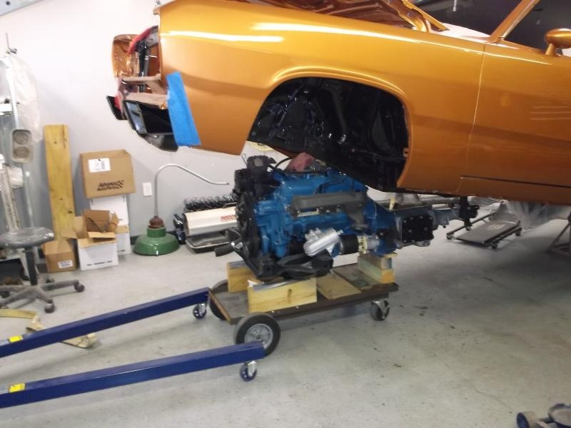

Never removed the hood. remove carb and distributor (5 min). Removed radiator (drain it while unbolting headers.) 2 motor mount bolts, and if leaving the tranny in, I had 4 bell housing bolts and 4 torque converter bolts. Left the starter in, All done from start to finish in 45 min.... motor on the ground. See the picture posted ^^^ above?? Not happening in 45 min. That looks terrible, ball joints, steering, brakes, etc, etc,. You can fight torsion bars and brake lines alone for a time, then blead the brakes when done, etc, etc, but he didn't have to remove the air cleaner... LOL
attachment.php
The car was coming apart for a full restoration. Everything stays as one unit until you are ready to restore it. You don't have parts stored in 10 different places...everything stays together so things don't get lost. There is NO better way of doing it if you are tearing a car completely apart. If you are just doing engine work then you are correct, there is no point in disconnecting the suspension.

Ok, another question. By the pictures the dolly straddles the hoist. How do you roll the engine out? Brace the body up that high and unhook the hoist?
Here my slant when I pulled it and right before it went back in. I welded up a cart, but seen plenty of pics on here with mover dollies. I ran chain around the bumper shock mounts (which I know you dont have), not sure what you can use but grab something solid the furthest front you can get. Might want to pull your grille off so you don't chance busting it. Four swivel casters will help manuever the assembly out the side with hoist still attached. I did not disconnect brake lines, just wired the calipers up to the cam bolt holes for upper arms.
I should of had the arm of the hoist out farther but my garage wasn't deep enough. The end of the hoist was right where the concrete drops off a couple inches. I ended up having to turn the hoist to the side in order to slide out the engine. If the hoist arm was out farther, I wouldn't have had to do that.
