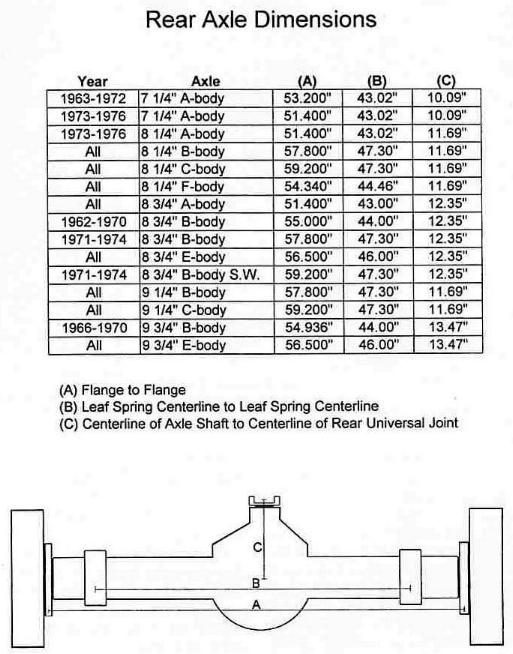

The 7 1/4" axle is not strong enough for a 360. You will have to make sure that you use either a 8 1/4 or the better 8 3/4 axle if you want it to stay together. To convert a car that came with a 7 1/4" axle to a 8 3/4" axle will also require to shorten the driveshaft about another 2". If you decide to upgrade, it's best to do both together so you only have to get your driveshaft shortened and balanced only once. :banghead:
Here are some charts to help you figure out axles:

Please stop using this chart. It's full of bad info.
attachment.php
It's one thing in the Mopar world that could be nuked from the internet.
Want good info. Go Here
http://www.moparts.org/Tech/Archive/axle/16.html
