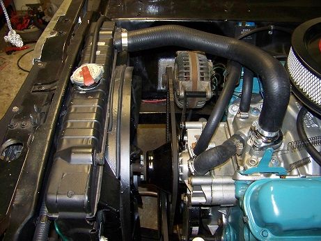

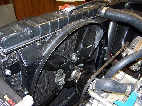

First the specs. I have a 66 Valiant that was /6 but now has a 318 with automatic trans. The engine has a very mild cam and a performer intake with eddy 4 barrel that runs a little on the rich side. Timing is 16 initial and 35 total. I have about 1500 miles on the engine and it has done this since day one.
I use a 195 thermostat that was tested in a pan water with a meat thermometer. I have tried 2 gages. One electric, one mechanical and both give the same reading. The lower hose has a spring in it so it doesn't collapse. I use a 50/50 mix of water and antifreeze.
I use a clutch fan and the radiator was used with my /6 with air conditioning. It was new and is rated for a /6 with air. Also has a shroud from the /6. I have a new Stant 16 lb. radiator cap that has been checked. I know some of the folks don't care for the lever type cap but it was checked and as long as they work properly I see nothing wrong with them.
Now, the problem. It seems that I can cruise all day long around town with no issues(190-195) but when I get out on the highway, the temps start climbing(up to 220-225 so far) and appears to want to continue to climb. It has never gotten any hotter because I always stop at that point not wanting any serious problems. Once it has got that hot, it doesn't really want to come back down when I get back to slower in town speeds but doesn't continue to climb.
I'm thinking the radiator is too small and not carrying enough coolant but I don't want to spend a bunch of money on a new one without having more knowledge about it. What do you all think? Sorry about the long post but you want details and now ya got them. Thanks in advance. Dennis

sounds like your radiator is to small. Try turning the heat on, fan on high and see if that helps drop the temp. You can also back off the timing 5* and check temp. Gasohol doesn't need a lot of timing.
I just went through the same thing /6 radiator and pretty much the same combo as you.Champion 3 row 22" cured it.

I think that fan shroud isn't doing you any favors because the air is missing a big part of where the hottest coolant is.
Lets say this is your radiator.
The red represents the hottest coolant area of flow, and the blue is your fan draw area.
In spite of what people think happens in a radiator, reality is more consistant with this drawing. (you can prove it with a temp gun)
See what I mean?
That being said, flow volume is usually the cause of overheating on the hiway.
Has the block been flushed out well. (hot spots can make it overheat)
What is the age of the water pump?
Is there a spring coil in the bottom hose.
Then there is also the possibility that it is the radiator like RRR mentioned.
Was it backflushed before it went on?
How do the tubes inside that you can see look?

Try it on the road without the fan shroud first....just for thoroughness. The way the shroud is setting behind the rad, and with the flat, shallow nature of the shroud, it is blocking a significant amount of the total airflow at road speed. The shroud edges should be completely outside the core area, and it should be deeper and more bowl shaped, not so flat. Even with a large rad, I would not want to use that shroud.
Also, is the rad core support opening such that the rad core is completely open to incoming air, or is it partly blocked? And are there foam or rubber strips around the front of the rad core opening to the core support, to seal the air pressure and force the air through the rad core rather than allowing it to flow around the sides of the rad? I ask because I have run a larger and moderately powerful V8 (300-350 HP) with a 2 row rad core and it was fine.
I would also recommend a different shroud. The one you have is not any good (don't mean to sound harsh, but just to the point). It's not letting the fan do its job. :eye:
The only opening in the back of the shroud should be where the fan goes. The purpose of a shroud is to make a "nozzle" to direct the air to the fan, so it can pull air through the radiator. With the openings that I have circled, you are not letting the fan pull the air through the radiator. The whole back side of the shroud needs to be covered and the only opening is to be around the fan with just enough clearance so the fan doesn't hit the shroud. Your shroud does not let that happen.
Your position of the fan in the shroud looks ok to me. This is called FOOS (and not Chip Foose), it is an acronym for Fan Out Of Shroud. The shroud should cover about 50% of the depth of the fan give or take approx 15% so the fan can draw the air through the radiator. The fan being too far inside or outside the shroud will hurt the ability of the fan to pull the air through the radiator.
The shroud's biggest benefit is when you are not moving or going very fast. I would find a better shroud.
Now in this case, I don't believe that the shroud is causing your overheating problems, but I took a closer look at it when Trailbeast mentioned it. He has a good point that the shroud is not adequate.
Usually overheating problems are when you are not moving fast or at all, you have the opposite problem. At highway speeds you get "ram air" effect through the radiator from the car moving and the fan is not necessary - that's when the clutch fans disengage.
Have you tried to spray the radiator with a hose when it's hot to see if it helps cool it down? When the car is hot/overheating, spray the radiator with a garden hose or car wash hose and see if the temp comes down. That will indicate if your radiator is the bottleneck/weakest link in your cooling system. It sounds like your radiator does not have the capacity to cool your engine (maybe clogged etc).
Keep in mind when looking at new radiators, area before depth. You get more benefit from adding area than you do depth, if you have the space for it. The thicker the fins/rows are, the more resistance to air flow it has. Thicker is not always better to a degree. I wouldn't go more than 3 row. If you have more area to increase the radiator size, then that will give you more cooling capacity without restricting airflow. You would be better going from a 18" radiator to a 22" radiator if you have the room, than adding more rows to a 18" radiator (this is just for example to prove the point and not implying that you have an 18" radiator).
I agree that your problem is due to not enough capacity for the radiator. But also recommend getting you shroud improved also. You want the whole package to be correct.
No offense taken to anyone here. I came asking for advise and I take it however it comes. I haven't liked that shroud since day one but it was "convenient". After I get with Gary, and hopefully get a new radiator, I'll build a new shroud that fits properly.
