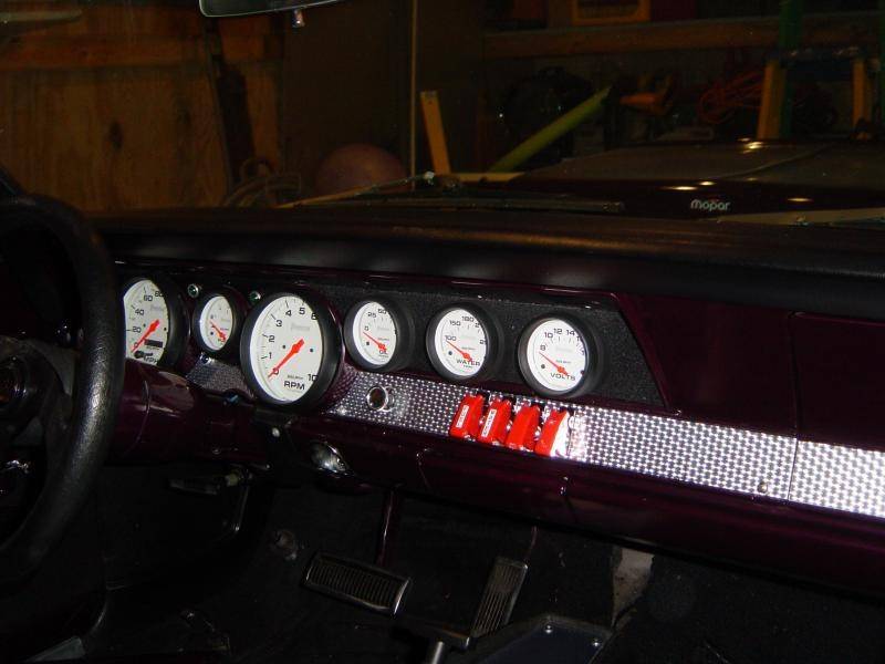

Check this thread, and check some of posters previous threads on their respective Clusters
http://www.forabodiesonly.com/mopar/showthread.php?t=95860
