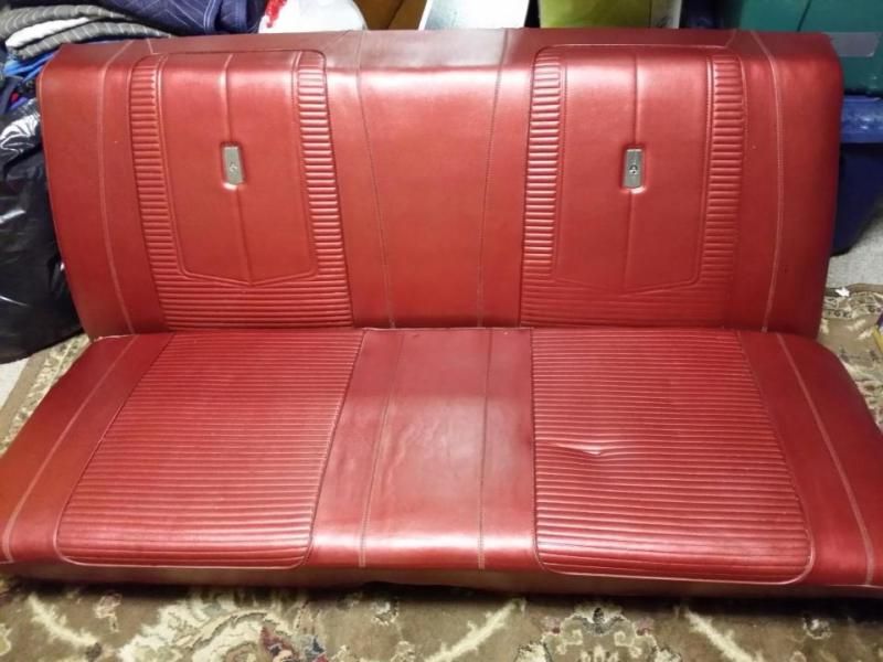

Car will be gunmetal grey with ox blood bucket seat interior

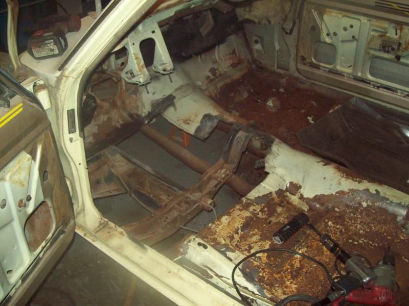

Last night I took the carpet and seat belts, all lower moldings ect out of the inside in preparation for the new floor pans that will be here tomorrow.

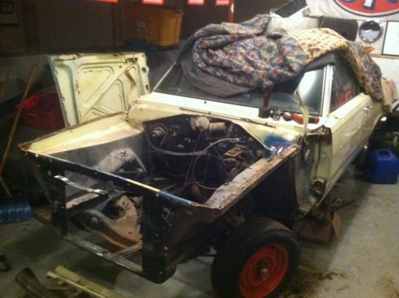

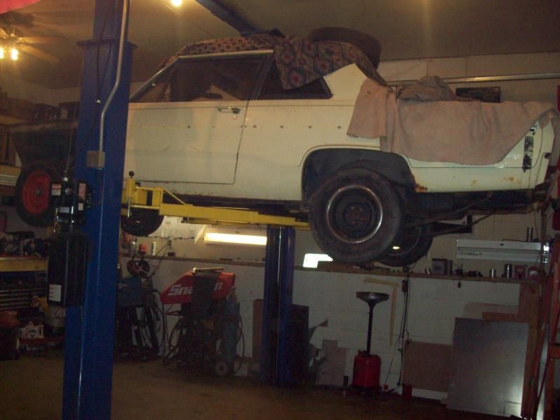

Tonight I took the front end off and set it all aside to be deliverd to the paint booth. I also got it on jack stands and ready to get cut up. tomorrow if I have time I will pull the dash, heater box, ect.

tonight I got the old floor pan out
Tomorrow and Saturday I wont get much done but I will have this side of the floor done by the end of the weekend. The other side my mid week. Then ill bring the Dakota home and really start having fun!

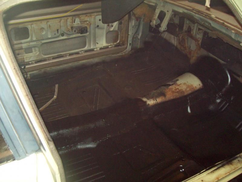

Finished the floor today and got it all coated.
As you can see I haven't done the tunnel yet. im waiting to fit the engine/trans before doing that.

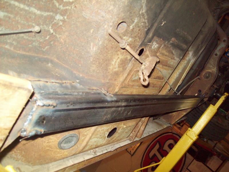

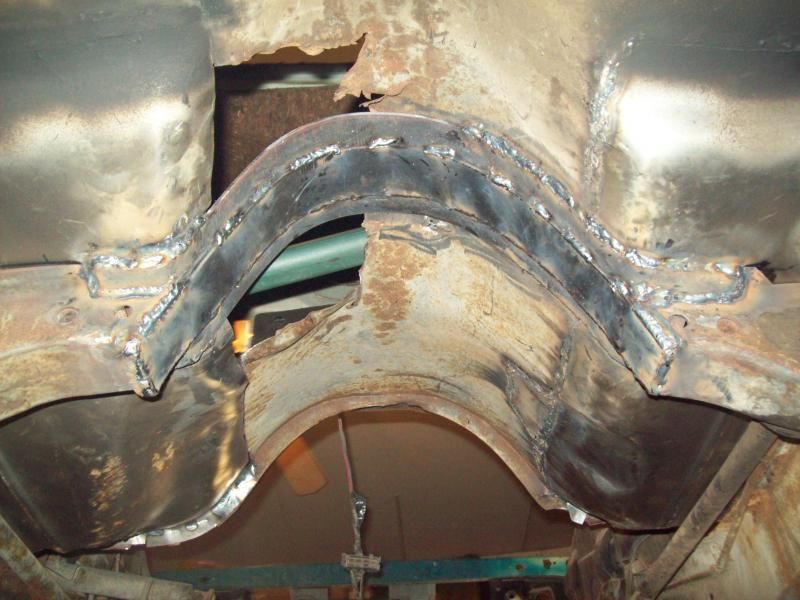

I also have the material to build the frame connectors. Should have those done before Saturday afternoon. Then, Ill be bringing the Dakota home to strip it down and prep the drive line for its new home.
This weekend i got the frame connectors done

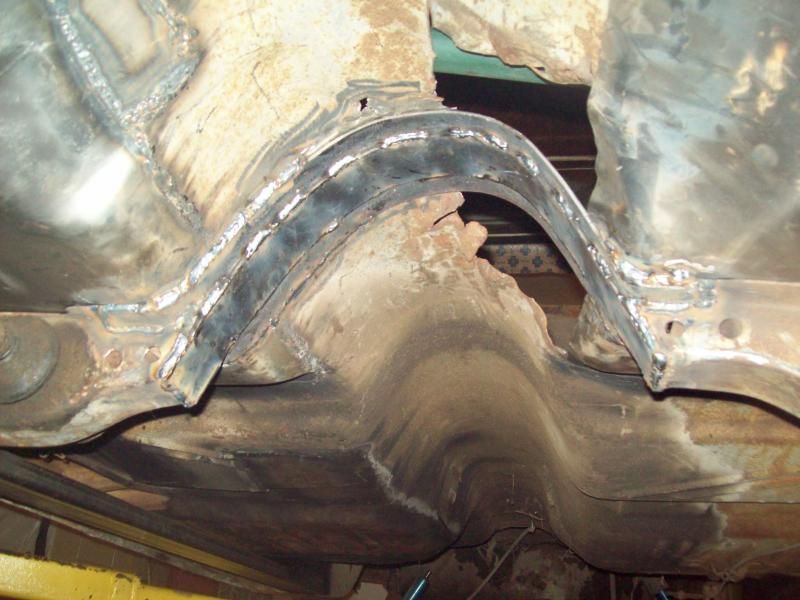

I did the mods to the cross member tonight to fit the overdrive unit on the trans
no turning back now;
but I got it handled

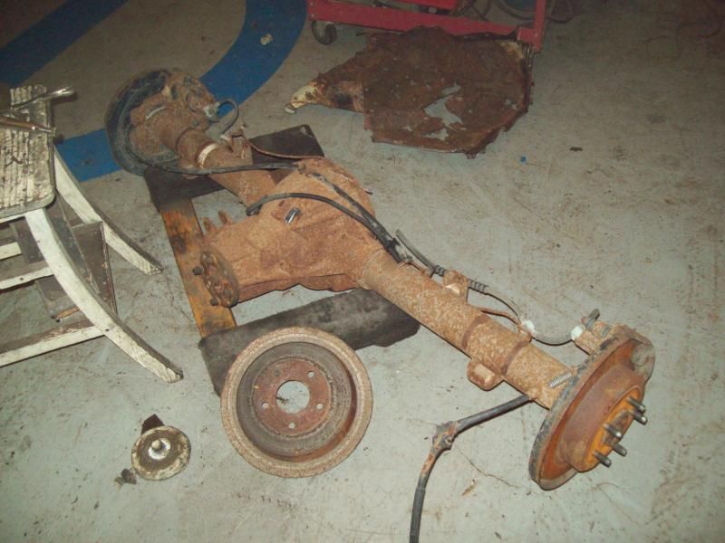

And a pic of the rear end because I didn't post one
