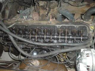

Damn, one of the valves was too tight. It would not idle for crap. I pulled the valve cover to find this: (remember, I was doing brakes while he tune and valve covers)
WOOF.
I got the valves adjusted, it quieted down a lot. While I have the valve cover off, I am going to give it, and the air cleaner a coat of paint.

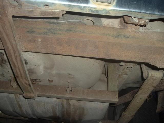

Under the rear is the HITCH FROM HELL. This SOMBITCH is welded to the frame, bumpers, an had re-inforcements. I could haul a horse trailer with this thing......
Damn, that is one hell of a hitch. Class 5 for sure!! Nice car to start with, looks pretty solid

It's amazing how they welded that thing to the bumper! That's gonna suck trying to remove that thing...sucks to be you! :scratch:
Bah, I kinda like the hitch. Maybe throw a trailer ball on there, make people think I actually tow with it.... "Bumper Protection Option"

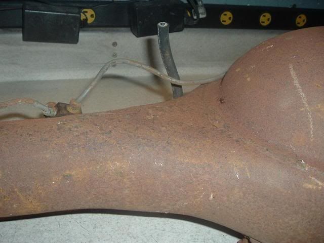

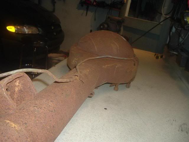

Made some excellent progress tonight. I got the workbench cleared off, and pulled the 8 3/4 for cleanup. I took a wire wheel in hand grinder, and wire brushed everything, and went a little further on the center section. I am nost sure if I am going to do any accent on the center or not....
Opinions?
Before
After

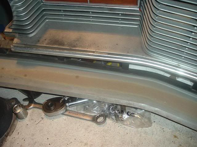

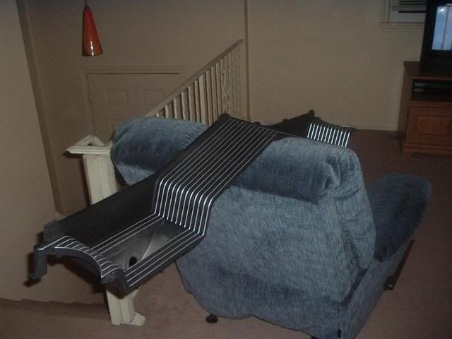

Updates on the grill progress.
I removed the grill with the intention of a quick resto. I couldn't decide on color code.
I posted here to get input. http://www.forabodiesonly.com/mopar/showthread.php?t=33911
I decided to go a different direction. I opted to go flat black, but then detail the "fins" silver, so it was a little closer to stock. The SHINY silver was too much, even though it was close to stock. The darker silver looked bronze against the brown paint.
In going with the flat black, with the silver ends, it very much resembles a billet grille from a pickup or SUV. I also silver trimmed the lines in the headligh surrounds, to continue the lines from side to side.

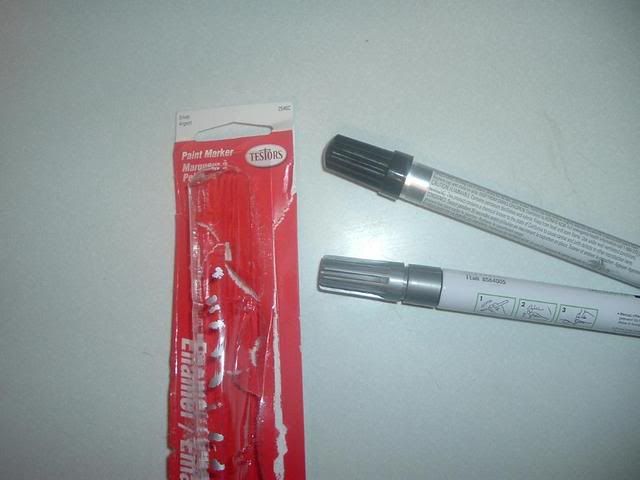

How did you paint fine lines like that? Did you use a brush or one of those paint pens? Looks good!
P.S. give me your 8 3/4!!
I used 2 of the paint pens. On was fine point, the other was broad flat tip. Broad tip was used on fins, fine point used on the "pseudo" fins around headlight buckets.

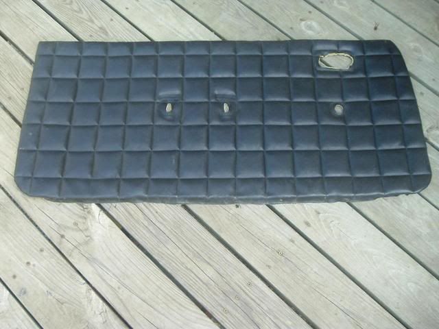

First to go was doors. Gears and latches needed to be greased badly. Hinges are still squeaky. Since the interior is where I spend the time, the door panels had to be fixed. It came with a home recovered disco square theme that was TACKY. This looked straight out of the 70's.
Here is the before pictures:

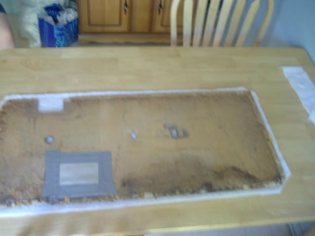

Here is the recovering in process:
Dodge in the Glue:
Installed on the vehicle:
I used black vinyl from the local fabric store, plus a foam "batting" (that is what the wife called it) plus a 2 cans of adhesive.
I used stainless screws, with a shouldered washer (stainless) from the local hardware store. I wanted black, but they did not have enough. Stainless will have to do. Maybe I can find some stainless decorative spears to add later.
Total outlay for fasteners, fabric, screws is just about 60.00 I have the other 3 to do, but I wanted to get one knocked out first, to see what I might need to complete the job.
