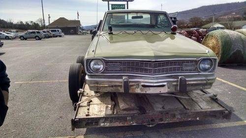

I bought this 73 Dart swinger, Just want a fun car to drive again
Any more info on the car? Or any specific info on the stuff your going to do to it..?
No rhyme or reason just picked floors as my starting place
The cars an original 318 auto, 904(rev is dead) w/ 7 1/4. Has a/c bench seat(repaired by previous owner). Quick paint job by prev. owner(I'm sure there'll be surprises under it). Standard rust in floor pans and trunk. Right now I want to patch her up get motor running and rolling. Then I'll move on to upgrades.

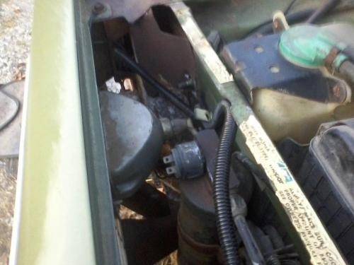

I bypassed the amp gauge and rerouted the alternator wires. Then I installed a headlight relay kit. Sorry for the blur.
Fixed most of electrical damage but may need wiper motor if I can't rewire mine.
I have LOTS of good wiring from 70/71 Darts.. enough to wire one whole car.. all in decent shape PM if you're interested..
