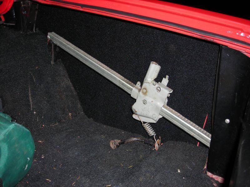

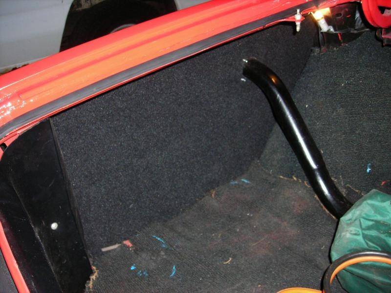

I finally got around to installing on the Duster, if your careful you can do both quarters and have some left over. I did but it was dumb luck as I had not planned on it.
gdonovan, that looks really good. Did you just use spray adhesive to attach it?
C
That really looks good! toolman
