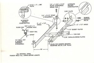

This one is on my 67 Cuda.........Look over to the left, and you can barely see there's a steel bracket that I bolted to the structure........I welded up the brackets in 2 pieces to bolt to the frame of the car at an existing frame hole.....dang, I thought I had another pic...........Best I can do for now..........works GREAT, and is almost completely hidden with no ball in there.

The trailer towing section indicates "loaded trailer weight must not exceed 2000 pounds".
On tongue weight: " if the tongue weight exceeds 150 lbs, equip the vehicle with a properly installed frame-type equalizing hitch (see illustration)" .
(as per illustration above)
I personally wouldn't go above 200 lbs tongue weight.
