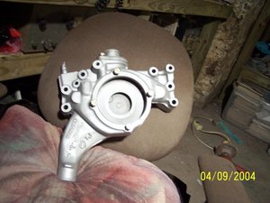

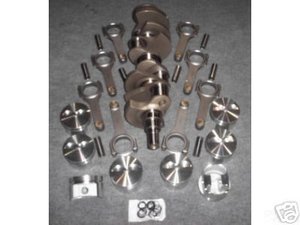

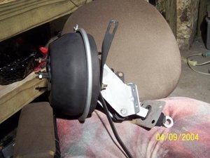

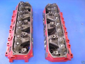

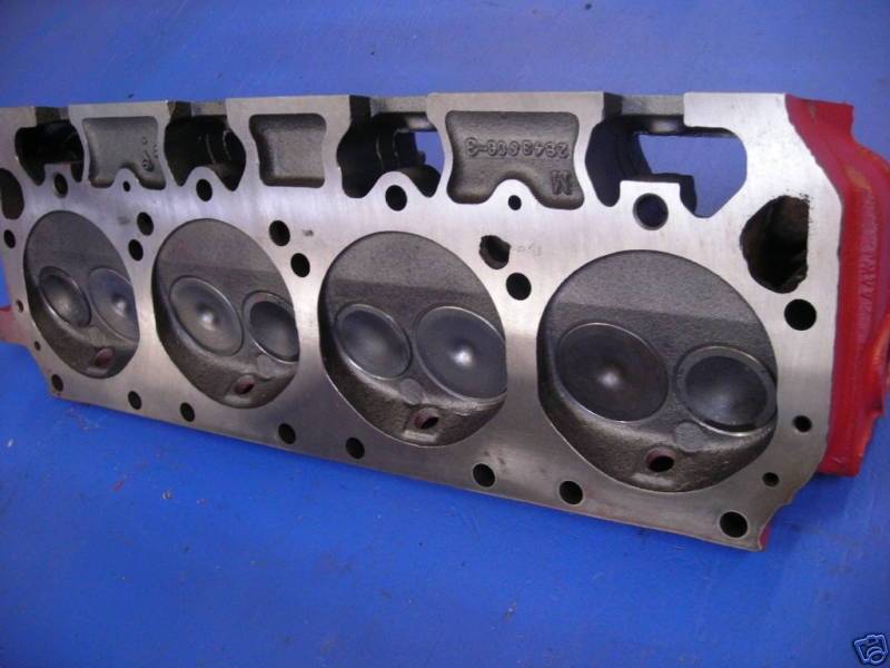

well ive got the quarters hung and the mini tub done just got spring reloction kit and going to start cutting and welding again lol and the 440 block is at shop gettine bored 55 over stock for the eagle stroker kit 499 with 10 to 1 pistons and picked up a set of heads 906 casting with street port and valave job and double springs and i got a new set of greg weld race lite wheels 15x10 rear with 6 inch bs and 15x5 fronts i will add more pics of the mini tubs and fiberglass front clip when i get a chance thanks for looking !Bmrvf3!CGk~$(KGrHqUH-CcEtst!Dgh2BLgdsbQlew~~_3.jpg

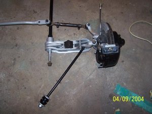

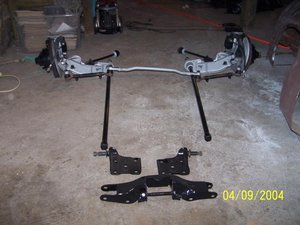

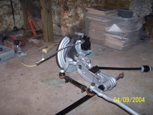

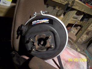

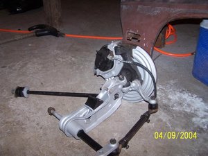

but here are some pics of what ive been doing with the duster frontend parts trans cross member and rear spring plates duster parts 001.jpg
