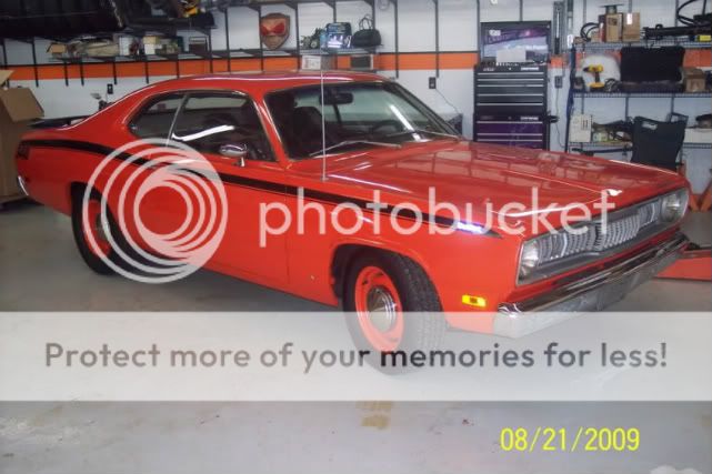

The Hot Rod has been done for about 10 years now and it needs a little freshening. I’m going to remove the Hemi and install a new clutch and pressure plate. I also will install a new set of TTI headers with QTP electric cut outs….
I hate to do it but I burnt the clutch up at the Nats this year!

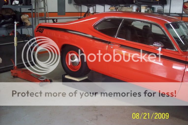

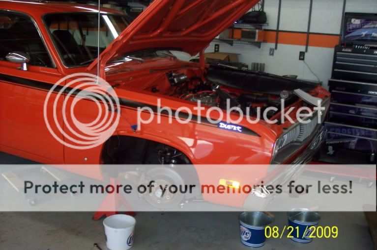

First I put the back wheels up on ramps
Then the front on jack stands

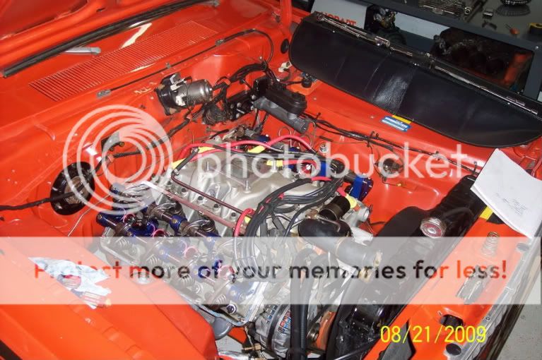

Then remove valve covers and all wires, gas line, etc......

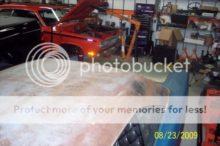

I attach the engine hoist.....
another shot of hoist, 69 RR for sale!

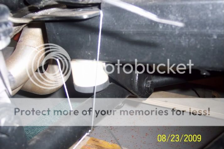

I tie up the front suspension

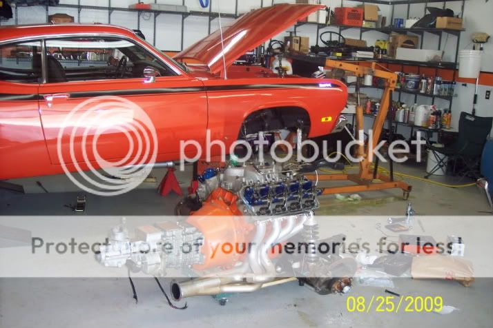

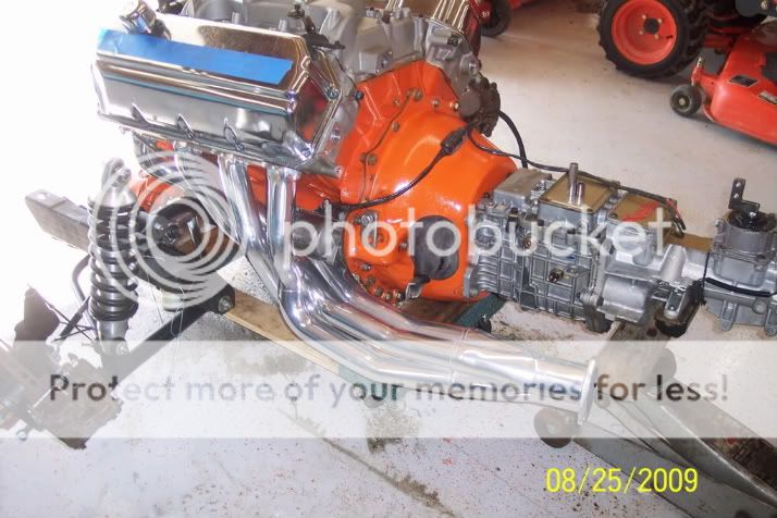

Now its just a matter of holding the engine in place and un-bolting the trans and K member........once its un-bolted you lower the engine onto a waiting moving cart.
You put a chain on the bumper brackets and hook it to your hoist and raise the front of the car high enough to roll the engine, trans and front suspension out from under the car...
And here it is.........
Now its easy to work on!!!!!!!

What K-Member are you using and what did you do to move the heater blower back to clear the engine?

The k-member is home made by a friend and member here, HemiDenny.... the heater motor is fake. I removed the innerds and just moved the housing back to where it was out of the way. I did read somewhere a guy from canada found a smaller motor and was able to use the heater/blower moter but my my terri cloth towel works well as a defroster!
