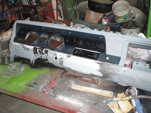

Smoothing all the extra holes on the '68 dash (this pic is on another dash that I was welding on to figure out my settings the actual dash has much much cleaner welds)

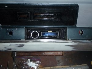

After I had everything welded up including the ash tray
Yes I cut a decent rally dash bezel:cheers:

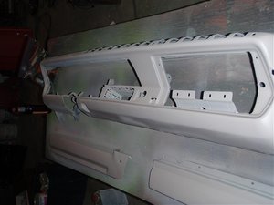

Dash frame in primer note the welded in radio support, I don't want it going anywhere
