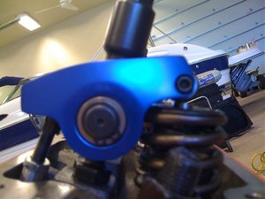

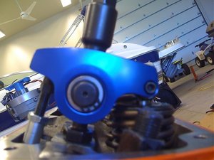

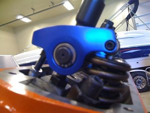

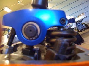

Ok, I may be going blind It seems to be Ok after doing the Wipe Test.
The Roller Tip Rockers give an OPTICAL ILLUSION along with me going BLIND I guess.........The whole process is VERY DECEIVING to say the least!!
First Picture here at NO LIFT.
No Lift again
This is at 1/2 lift
This is Full Lift

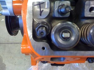

This is the Wipe Test.......I put a magic marker on it and the marks barely showed up so I cleaned it up and used a straight edge to show more detail of what is going on.
As the Rocker tip goes down it moves across the valve toward the exhaust and then back to where it started.
Dave at hughes said to me this morning that with the new SHAFT mounted rockers the Rocker tip will start just off center toward the valley, go across the valve at mid lift and then end up where it started at full lift reversing the process when the valve goes back to the seat or NO lift position.

That pattern looks real good to me. I don't see a problem with it.

With the permanent marker it didnt show up very well, I kind of moved the rocker back and forth just enough to make a mark on the valve itself at fully closed and full lift. Then I used a straight edge and the permanent marker to show what you see..............I still cant believe the OPTICAL ILLUSION that I was getting just by looking at it. I guess it is because the furthest part of the roller tip since it is round is hanging off the valve??
