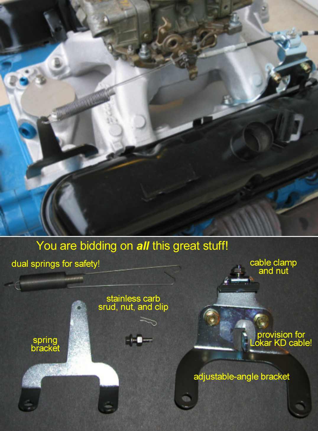

I'm with moron on this one. Just engineer a new mounting bracket for the existing cable.
Looks like the metal you fabbed is black? my problem is the cable is way too long. I may just shorten the existing cable.
Yes, its black I was lazy and didn't paint the thing;
it was in the junk pile, it was a yard gate latch, needed to get the
cable further to the rear and towards the drivers side fender more.
I would not suggest you shorten the cable, the V8 cable is tough to find.
You have other options, you can buy a throttle cable clamp from Ehrenberg.
http://tinyurl.com/yjjctzw
Interesting set-up. Your cable looks shorter. Also interesting set-up with the kickdown. Had any problems with it being on the inside of the linkage?
No problems here, the kick down linkage rod, is not the one that came with the 2bbl on the car;
its one of a pair I bought {by sight} at a swap meet, and hoped that one would work.
These old cars, when modifying, them, sometimes calls for a little thought,
and trial and error.
I am using an Edlebrock # 1406 carb, and drilled the carb linkage hole,
larger to use it for my cable's stud. Why wait for a week for an adaptor from Jegs or Summit when I had a cordless drill here to carefully enlarge the hole slightly.
The linkage doesn't bind, and the kickdown works. :)
