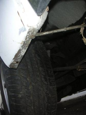

With the lower fender support brace, you can adjust the fender outward to give you a little more room. Or you can even drill another hole forward of the factory hole and that will push out the fender even more. I did that with my 68 Dart and fit 245/60/15 with 15x6.5 rallye rims. I pushed the fender out a good 1" or so.
So I guess it's safe to say that 4" backspacing is the best bet.
Since you don't have a front valance keeping the bottom of the front fender rigid, I think you can adjust it to fit. The fender edge will probably need to come out an inch. At least a 1/2". So unbolt your support brace now, pull the edge out an inch or more and see if that works for you.
Here's what I did to my Dart.
The factory fender support hole is in the rear.

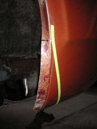

This is a little off topic. But this is the process I used to lip and bend back my front lower fender lips on my Barracuda to fit those real wide 15x9 minilites with only 4 1/8" backspacing and 245/50/15 tires. Same idea just to a lesser extent can be used for other cars.
I got a set of Minilite copy rims made by Optima at a swap meet a couple years ago for my 68 Barracuda. They are 15x9 with 4 1/8” backspace, -0.9” offset. I wanted to run them with my 245/50/15 tires that were previously on my 15x8 rallyes with 4.5 backspacing, and 0.0” offset. Obviously this was going to put the tire out closer to the fenders and I was close right now.
So I lipped the front fenders. I did this because in the future I will be running 275/40/17 on 17x9 rims as funds allow. I knew from others experience I had to move the front lower edge of the fender back. I installed a spare 245/50/15 on the new rims to mock them up.
The idea is to have the rod supporting the inside to fold against and get a contour. I had hand dolly also supporting the rod. And the key was small hammer blows and having patience. It ended up being pretty much a straight line because I didn’t put a couple relief cuts in it. Oh well, I feel I could reverse this if I had to.
I think I could have got away with about ¾” less this much cut back.
