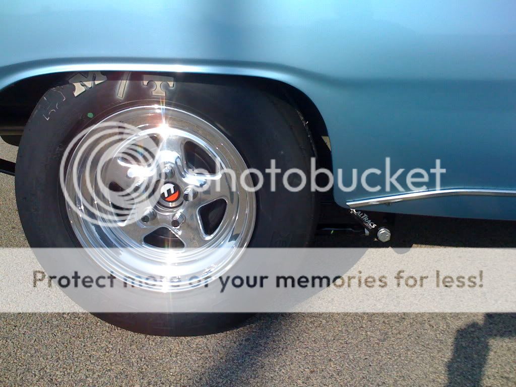

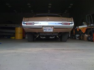

On my 70 Dart Swinger with factory spring location no cutting at all, I used Mickey Thompson Indy/SS 255/60/14 Tread Wear is 0000 on 7" Wheel with 4.25 Back space. Fits like a glove and I Run the Piss out of the thing and they have NEVER rubbed! I have a 4spd that is the only reason I didn't go with street et's and I wanted the Factory look from the year of the car with 14's. They Hook pretty darn good with the 410 stroker and 3.55 gears. This set up puts EXACTLY 9" of tire on the ground!

Maddart, thats a nice fit. they look good.
Thanks!
I have been experimenting with tire pressure and 22lbs in the rear is the sweet spot for now. I need to fine tune the pinion angle which I will be doing in a few days. Then I will experiment some more.

mad dart, you have to be the fist guy i ever heard that could get a car to hook with those tires.
The Tread compound on these tires are the same as slicks, they are VERY soft with a tread wear rating of 0000 just like a slick. I run 22lbs of air in them and the Caltracs do their job, but I do need to play with it some more and adjust my pinion angle then bring the caltracs level to the ground as possible. Then it should hook really good!

The car is an original 340/4spd that came with an 8 3/4 rear end. I have not done any modifications and it is still in factory trim. No rolling the wheel lips, spring mods or anything. WIth Spring Mods I would have to dump at the rear axle. I like it to be a sleeper with the Exhaust Tips going all the way out to the rear of the car. Then I flip a switch and open the cut outs and I Bite them hard with the 410 stroker! :toothy10: haaaaaaaaa

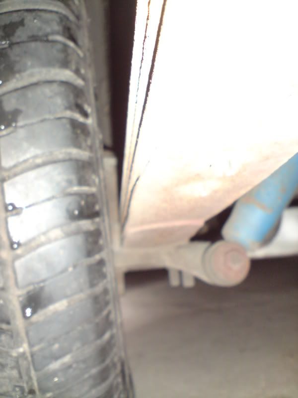

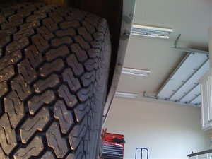

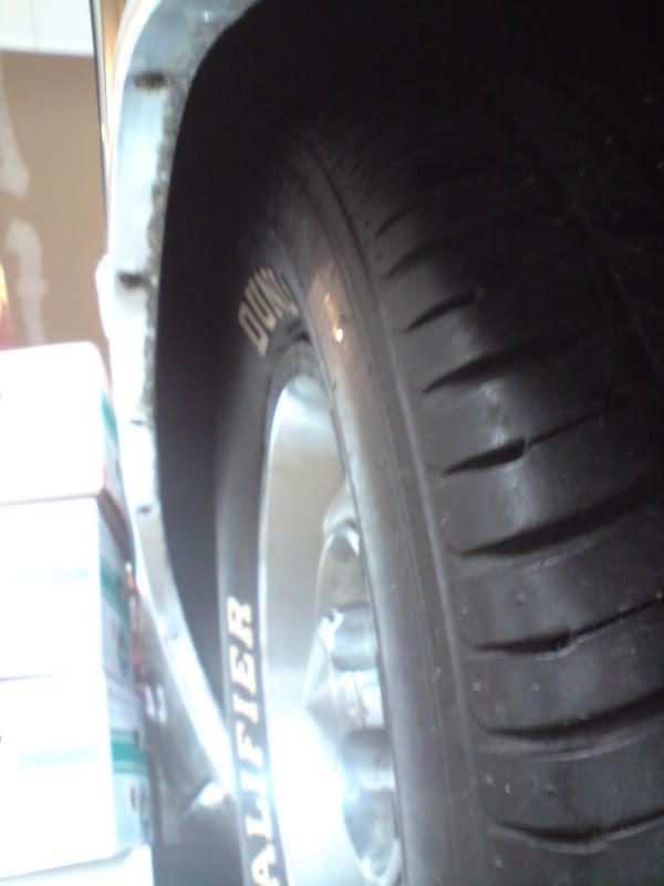

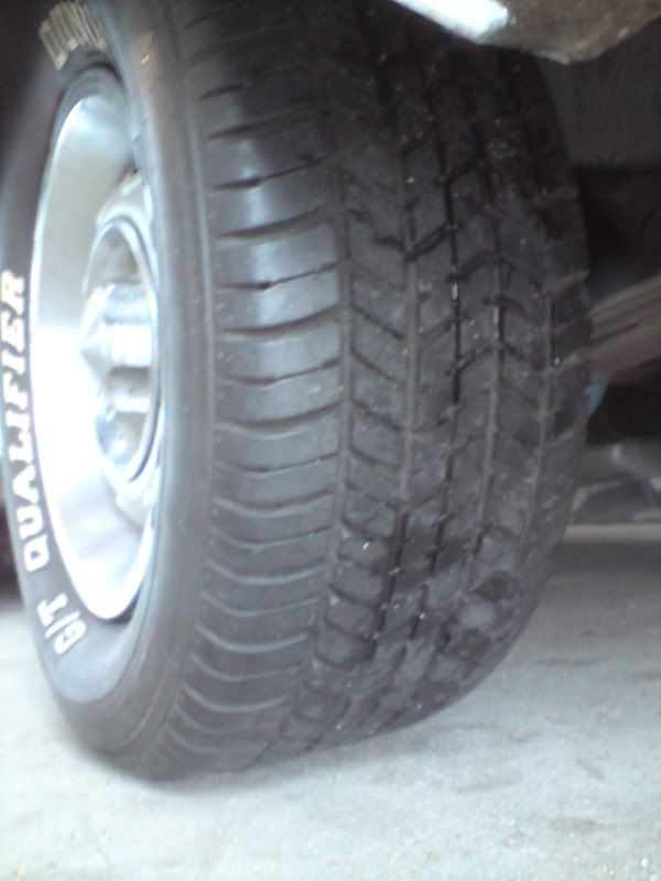

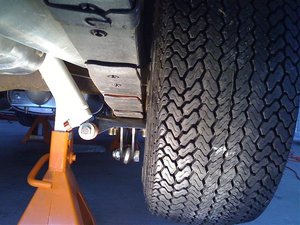

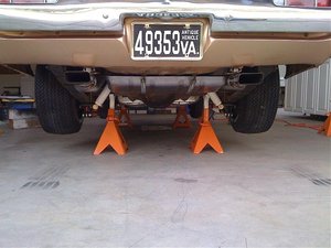

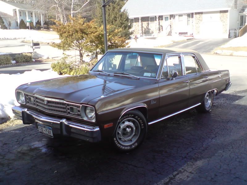

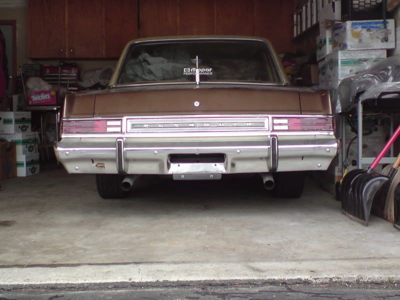

Well here is my contribution to the thread and forum. I just picked these up for my 1974 Valiant (formerly 73SwingerBuild's) and took some pictures last weekend.
The tires are 215 fronts and 245/60/14 rears. The car has an 8 1/4 rear end, completely stock suspension, and rally wheels off of a 72 'Cuda.
Clearance to Springs:
Clearance to Fender:
Hopefully that can help someone out who is looking for wider tires.

Valiant looks great man. Since we both have the 8-1/4 I'll probably just go with 245s to keep it clear...might use 4.25" BS though.. push the tires out towards the fenders a little.
