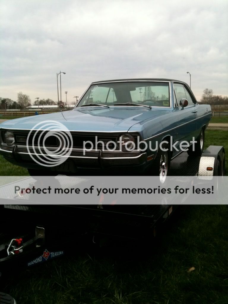

Track opened so I got the car together the best I could and took it out to Terre Haute on Saturday.

hey sorry to hear....but the dart looks terrific! I LOVE 70 darts!!! hope you have it up and running in no time! just get another junkyard 5.9 and ull be good to go!

It's actually a '71. If you look closely you'll see the "DART Swinger" emblem on the fender.

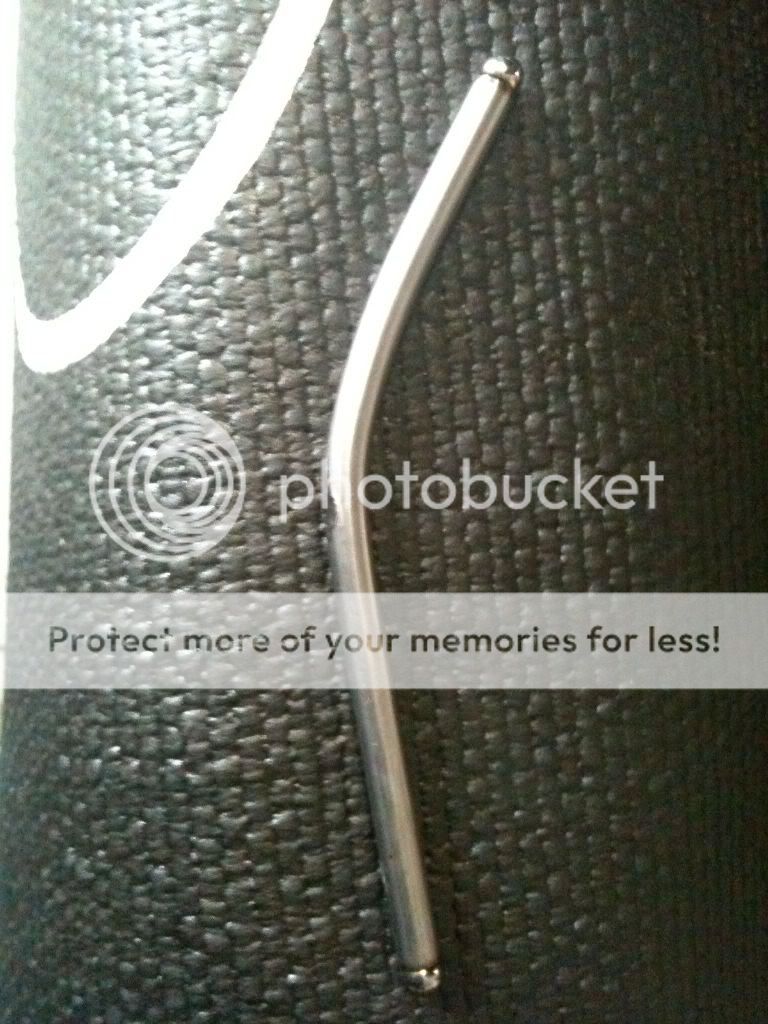

Got it apart last night.
Here's what not to do. Don't have a problem like this, then put in an Autozone pushrod to see if you can get it on the trailer without pushing.
IT busted the ball off the end of the pushrod and jammed the lifter in the bore at full lift. Then the pushrod hammered on the lifter a bit, taking a bite out of it.
Fortunately, I quickly turned the thing off when it started making the nasty metal on metal noises, because it looks like it would have just gotten worse. Even MORE fortunately, I had a bunch of friends to push the car up on the trailer, and some other ones to help push it in the garage at my house.
The lifter came out easy enough. Removed all the hold-down stuff and tapped it lightly with a hammer and it popped down. Lifter bore looks good. Cam looks good also.
My block has a battle scar from the pushrod ball...
All of the other pushrods/lifters seem to be fine (going in the trash anyway).

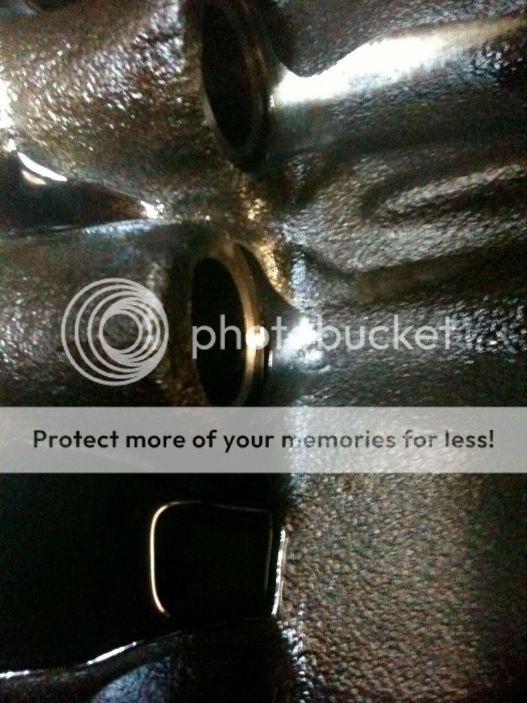

Doing a leakdown tonight. Kind of dreading it, but really hope I'll find that the valves are not bent. Its hard to tell, but it looks like the valve stem tops are a little dis-similar height-wise. That's probably not good.
An air line with a blow gun into the spark plug hole will tell you if the seat is leaking air (meaning valve is bent). I really like the Smith Bros pushrods. The hyd roller ones are pretty short and it's a steep angle on them. I guess if Comp said the springs were ok they probably should be.. Can you remove one or two and test them?

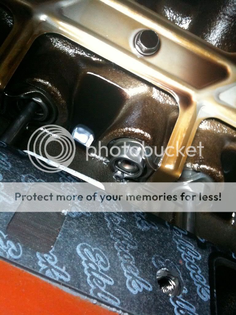

Called Hughes today. They Iron Rams are not upgradeable without machining the seats. Hmm. Should have had that done when I initially bought them. Talked to Tim over there again today. He says that the springs I have should be fine for this cam, which matches what Comp says.
If the heads have to come off, I'll have them machined. If not, maybe I'll have to stick with what I've got, but I'll buy a new set if it rolls that way.
Either way I'm going to measure everything when I've got a couple of springs off. Maybe I'll get lucky and a shelf Comp beehive or something will fit.
Steve
Steve, as good as your car is running, if its just a pushrod issue, i'd replace them & leave it the way it is, i'm sure it'll hit 11.99, that is Damn good for such a mild combo.
Were the springs checked for bind and retainer to seal/valve guide clearance with the higher lift from the magnum rockers? When I see bent pushrods, that's just the first thing that comes to mind.
