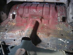

Yah I didn't have to much work comming my way so I was home early. here's what I did get done
1. got the axle hump out of there , lookin pretty bare in there
2. got replacement trunk extensions 1 needs work but the other one is nice
I HATE spot welds or at least drilling them out. I just tell myself only a couple thousand more to do ,,nahh doesn't help I still hate em

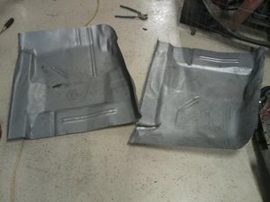

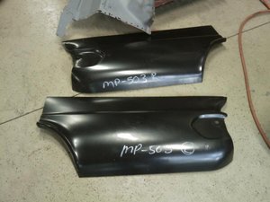

I came home from work and discovered that christams had come early!!
My floor pans and both rear patch panels came in today, It motivated me some much I had to put some metal Back on the car
my new (to me) pan but not welded in until I check the Squareness of the body. it looks good and I tack welded the frames to the body dolly but I

ohhhh new toys
more new toys
