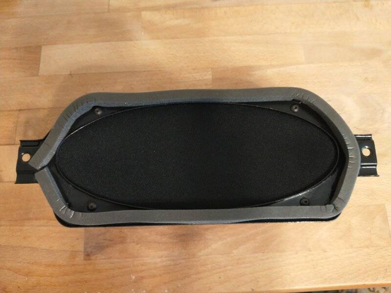

I have a speaker adapter and can measure it up for you .
Give me a half hour or so.
ok the "or so" should have been 2 hours. seemed like it was 30 minutes.
I sent you a PM
Speaker is a 4" x 10".
It mounts to a bracket, which in turn mounts to the underside of the dash with bolts whose heads are covered by the defrost vents.
Which dimensions do you need? Hole to hole on the tabs on the ends? Or the holes on the speaker that mount to the bracket?

thanks for all the help everyone! I was looking for the hole to hole on the mounting tabs, and possibly the width of the speaker itself, I’ve seen brackets that seem a bit offset.
@Dana was able to answer the questions .
I do appreciate the pictures, I was looking at the retro sound speaker but didn’t realize there’s a bracket as well. I thought it was a special speaker with extended mounting tabs ha.
These pictures definitely clarify everything

The Retrosound speaker isn't anything special as far as sound quality, but it does have a couple features that are helpful. It can be wired to be an 8 ohm speaker to work with the old radios. Doing this requires losing the stereo feature it has if wired as twin 4 ohm speakers. If you're looking for 4 ohm stereo, you're better off using twin 4" speakers and a homemade adapter. It'll give you much better sound than this speaker.
The Retrosound has a slim profile which helps it fit in a pretty cramped space.
