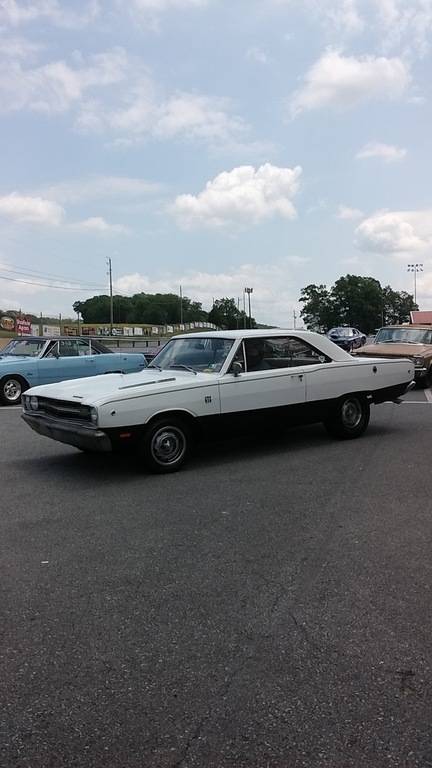

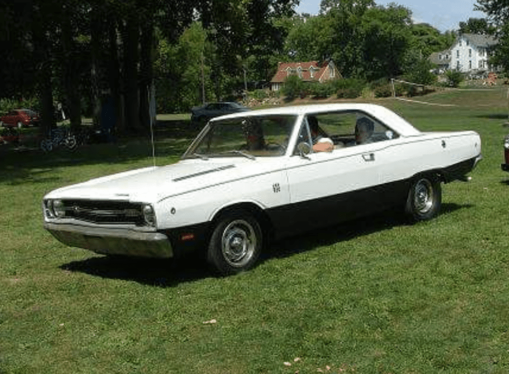

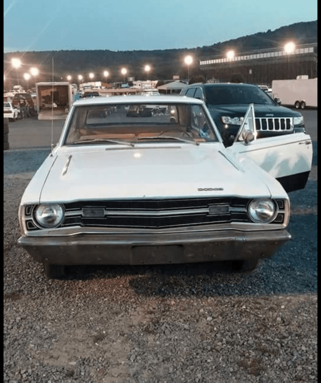

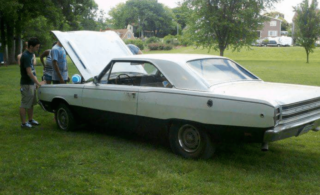

I'm in Stevens, PA between Lancaster and Reading. Title VIN is LM23P9B175499. I knew the car 10 years before I got it and I've had it at least 10 years. I was a diehard Chevy guy (you can see my 51 Chevy truck behind the Dart in the one picture). Drove the Dart and had to have it. Bought it after my friend's divorce. The MOPAR friend bought it the way it is, thinking it was a GTS. We didn't know it was a Swinger until last year when I joined this site and discovered that GTS never had a bench seat. Then we ran a VIN decoder. It's possible the front fenders and hood were put on from a 68 at some point for the GTS look -- Learned something new again. *Edited to add: 68's don't seem to have the reflectors on the lower fenders or quarters. I suspect the round marker lights were added to the original 69 fenders. I'll look closer when I get it out for more pics.
I will get more pics today to upload, especially the VINs, interior, under hood, etc.
You have a '69 GTS hood and grille. The rear panel and taillights are '68. You have '69 front fenders with stock rectangular reflectors, with '68 round side markers added. You have '68 rear quarters with '68 round side markers. Round side markers were stock on all '68 Darts, only. No '68-'69 GTS ever had "DODGE" on the hood. It should have a GTS emblem in the center/front of hood. '68 had the GTS badges on the fenders, '69 did not. And you're right, GTS's did not come with bench seats. Basically, you seem to have a hodgepodge of parts!
I confirmed with the previous owner that he added the round side markers on the fenders and quarters. Are the rectangular markers on the quarters a feature of 1969?
'69-up Darts had the rectangular fender marker lights. Actually, on '69s they do not light up, they are just reflectors. '68 is the only year that had the round lights.
That is a 69 swinger hood. 69 gts grille, 69 tail lights with a 68 trunk panel. Looks like a swinger with the side markers off a 68 added, the 68 trunk panel and gts emblems on fenders. .
