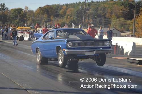

Looking to put 15x6 in wheels on front looking for recommendations on tire size for my 1971 duster pics would also help looking for the skinnier in the front i have 15x8 255/60/15 on back

Looking for a racy type look dont want a real wide tire on front had a 15x7 rim with 225/65/15 now have 15x6 wheel want to bring rim and tire in more than what my car looked like before
