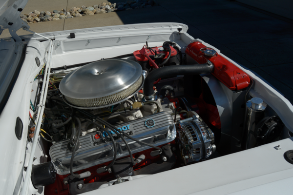

I recently installed a pro-built 273 / 4-sp in my 64 (originally a slanty / auto. It still has the original small rear axle (7 1/4 ?) I need to change the rear axle ratio to a lower (numeric) ratio. What ratios are available? Currently it runs at over 3000 at 65 MPH. I have no plans to race CUDAVRT, just use it for rod runs and crusing. Any help is appreciated!

You should have 2.93's in there now, what diameter tire are You running? 2.76's are common as dirt in later models, but would only drop You to 2,826rpm's, maybe You have a hard-to-find set of 3.23's....in which case it would drop You to 2,563rpm's.
you looking for gears or to swap the entire rear end? just gears, 5th aves came with 2.24's in their 7 1/4's, that would put 70MPH right at 2050 RPM ignoring converter slip with a 215/70R14 tire (a skoash under 26"), more if your tire is shorter.... a 2.76 puts you a touch over 2500 RPM @70 with the 215/70R14. >3k@65 sounds like you have a 3.55's (or 3.23's with a really short (24" tall) tire)

I'm sure that I currently have a 3.23. I raised the rear end off the floor with my floorjack, marked the wheel and the driveshaft. The driveshaft turned about 1.2 times for 3+ turns of the wheel. Tires are 205 / 60 R15 Goodyear which Tire Rack logs at 24.7 inch diameter. So it looks like a 2.93 is what I need along with a change of the speedometer gear in the transmission. Assuming I'm correct, where can I get a rebuilt replacement?
2.94's might be a little tough to find. I'm thinking 2.76's might be easier, probably look at newer (73-76) A bodies with autos and drum brakes if you're still small bolt pattern.
Will the 2.76 directly bolt in the original carrier? I'm running '64 axles, and the wheels are dual bolt pattern. Drum brakes. The 273+ makes something north of 275 HP so there should be plenty of torque at 65 mph to haul CUDAVRT around. If all the above is correct, all I need now is a source. Thanks to all for your help!
