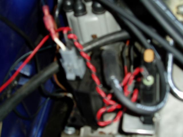

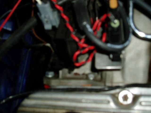

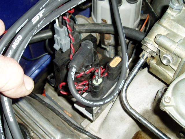

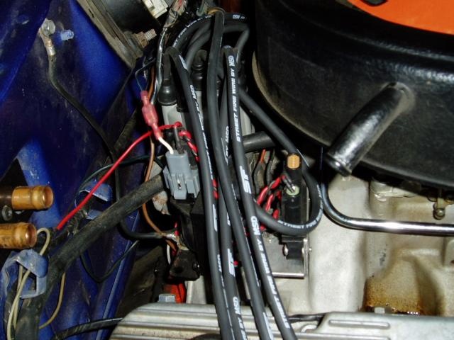

Here's pics of my son's install ,, tucked away where the old coil was, using the original bolts and holes, and hardly noticable with the AirCleaner on.. sorry about fuzzy last 2 pics..
We also had to upgrade plug wires, as at night,, there was a real light show,, especially when damp.. and it was scary putting your hand/arm anywhere near a plug wire... zzzzaaapppp... wow High Energy Indeed... lol..
