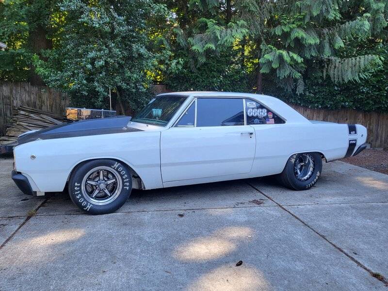

i have one car with a high ram and carbs and one car with ritter intake and carb. both stick out about the same. :steering:
