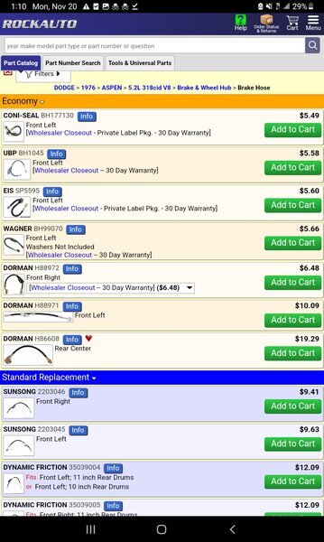

Buy the el cheapo aspen ones on rock auto and grind them on a belt sander or put them in a vice and cut them with a Dremel.
