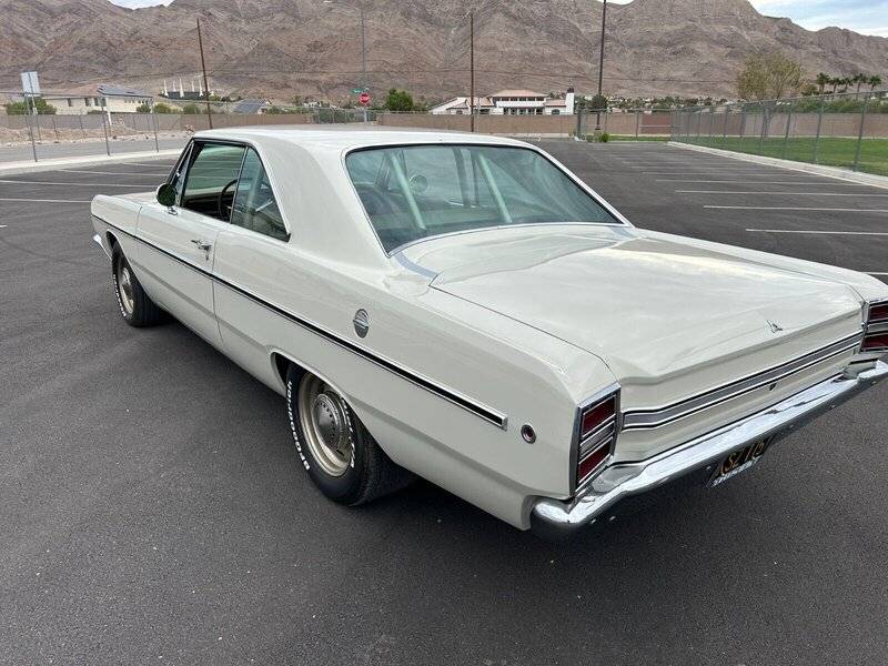

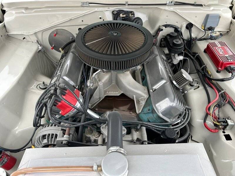

First of all, welcome to FABO!!!
Second, that Dart is Sleeperiffic Badassness!!
Last, if the cam is a hydraulic, it can skew the cranking compression results & barely even get You in the ballpark. Cranking speed, oil pressure while cranking, engine temp, design bleed-down rate of the lifters, all affect what You'll see cranking PSI-wise. Most track engines using that whistler are almost 100% solid cams, so keep that in mind.
