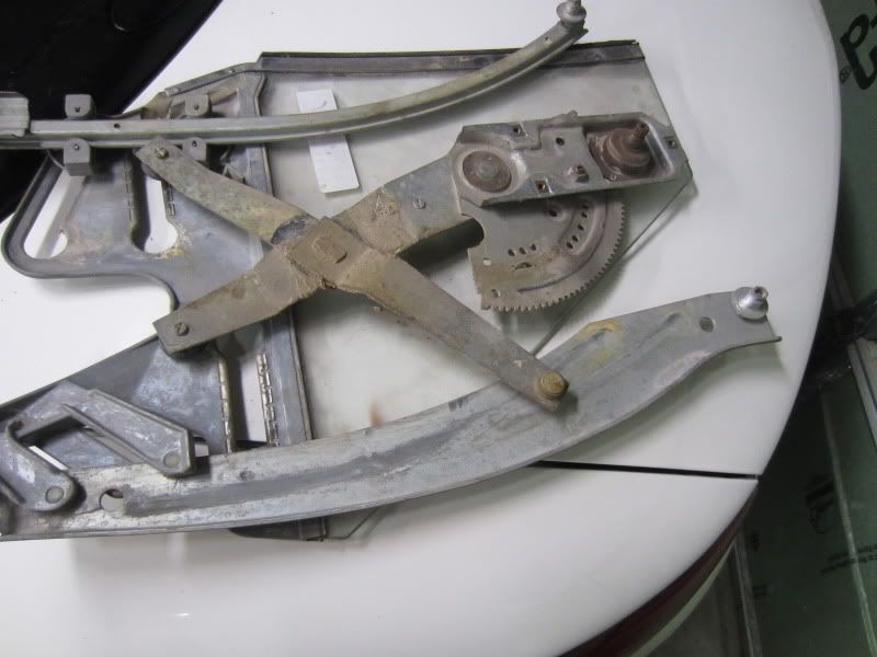

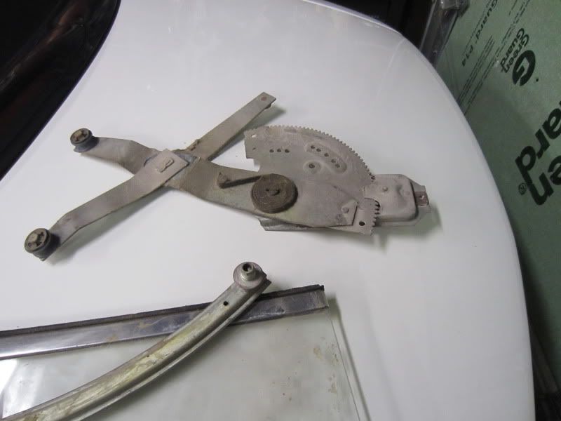

Im trying to decipher whether this is a rear vert regulator....It may be 67-9 cuda...not sure can anyone help, and if ya got them post pics of your vert rear reg.

No way to know for sure with those pics. The arm shown pointed north is where the difference is found. The length of that arm and the offsets in it would need measurements for comparison.

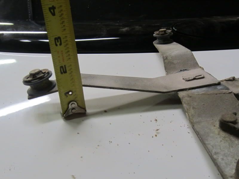

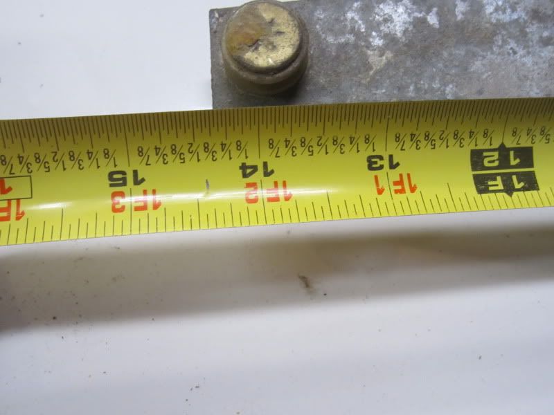

Ok, here are some pics with measurements. Sorry some of them are lousy.

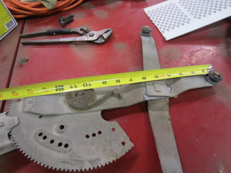

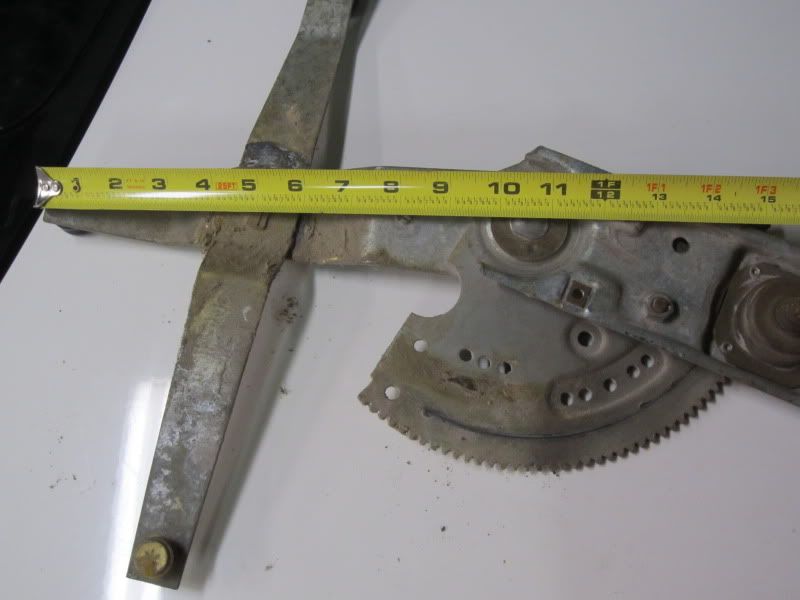

ok loos like I will have to dig them out again to compare measurements. Here are the pictures of the ones out of my car.
Thanks Carl, what about # of teeth?? Yours look the same as mine but....will wait for measurements...Its outta your 68??

Here are the pics with measurements out of my 68. If you need any different or better ones let me know. I left the regulator out this time.
