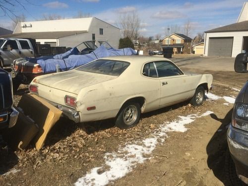

Hello everyone, I am from North Dakota as you can see in my handle lol. It has been several years since I have worked on muscle cars from this era. I used to run Fords but always had a liking for Mopars. My mother had a 73 Duster when I was young and I had wanted the car real bad. However, my dad sold it before I was of age to drive. Long story short I was in the oilfield working this summer when I saw an advertisement for a 73 Duster with a 318. It looked very neglected but it had a solid body.
Here are the pictures from the add.

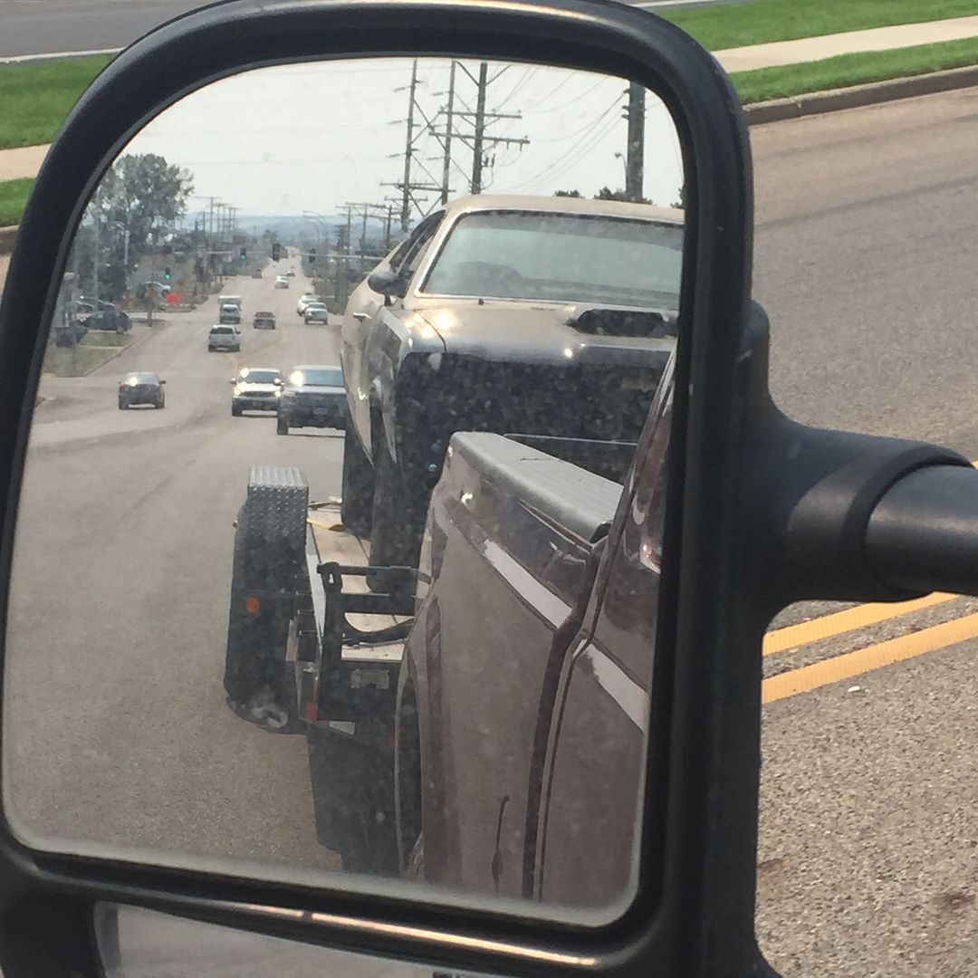

I worked out a deal with the previous owner and a buddy of mine came with and helped me load it up. Homeward bound we went.

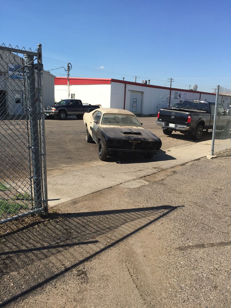

It was pretty dirty from the years of tree sap and dirt on it.
A little cleaning and it looked much better.

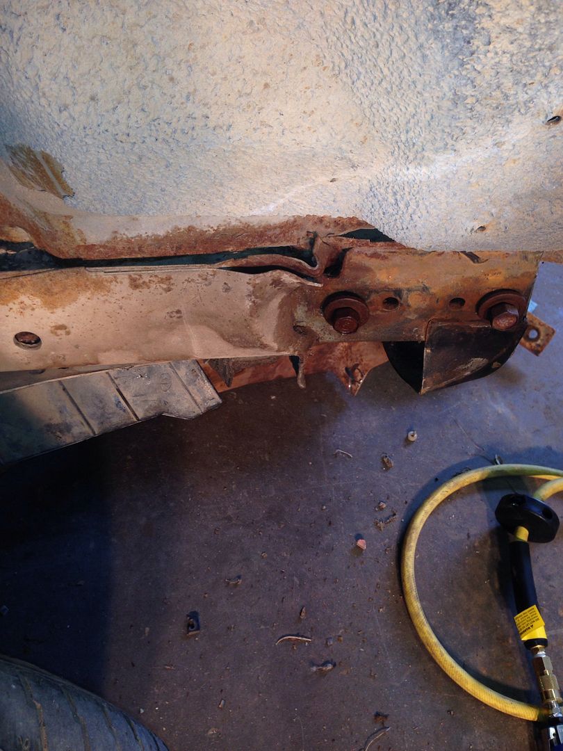

Due to some front end damage I had an acquaintance of mine who runs a frame shop look it over. He advised me to continue with the build and install the new body panels. Once finished with that it will go to him for the frame repair. He said by going this route he can make sure when finished everything including panel alignment will be correct.

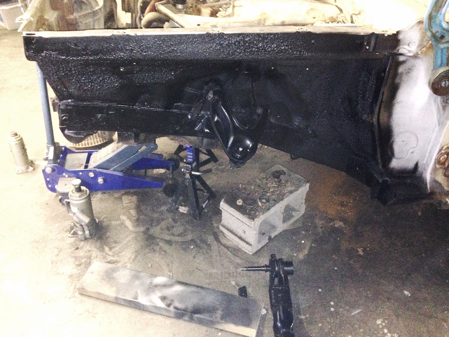

Here is the drivers side cleaned up, painted, and the upper A arm partially installed.
We rebuilt the entire front end, including torsion bars, ball joints, and all bushings. It is amazing how worn out the parts were. No wonder people complain of Dusters handling poorly if they don't rebuild them, bushings and all.

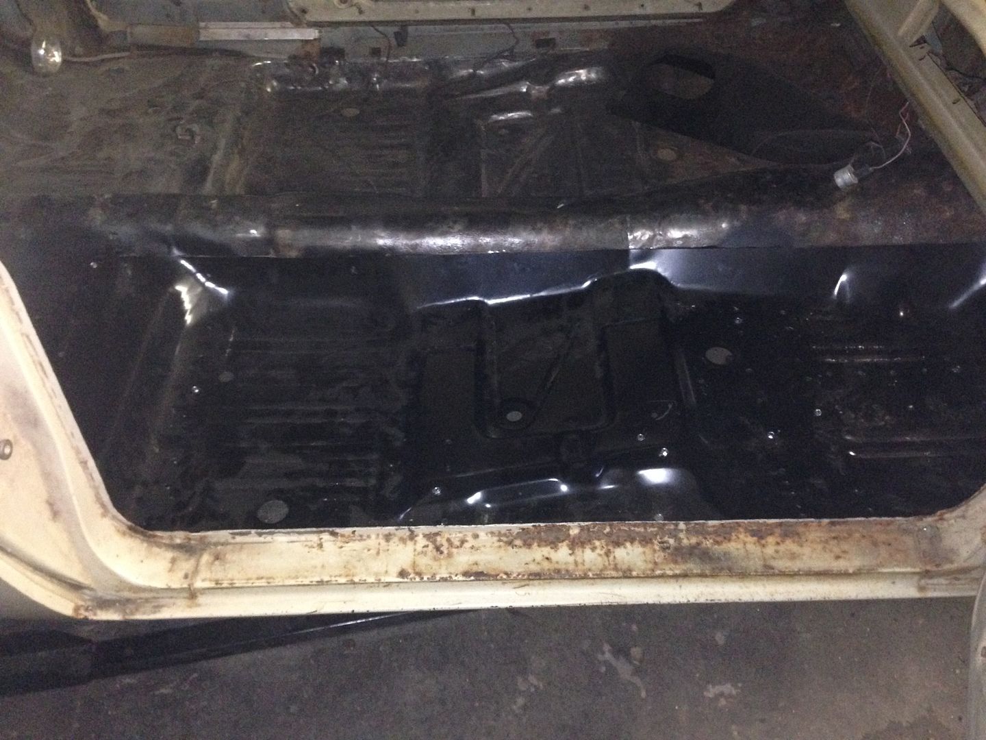

The latest update is the passenger floor pan was installed yesterday. Over the last couple days we finished fitting and welding in the pan.
Here it is fitted in place and ready for welding.
Getting a little Smokey!
Here is the finished product! One down one to go.

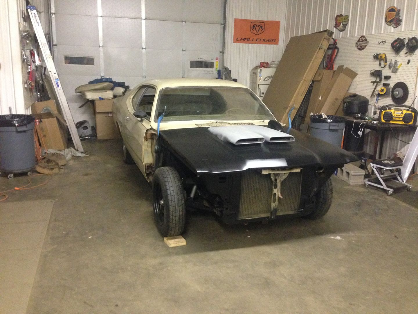

In addition to welding in the floor pan we fitted and welded in the subframe connectors I bought off of FABO a couple weeks ago. I also fitted my sport mirrors and installed my dual snorkel scoop and cut the hole for it in the hood. Starting to look like a car slowly again. On to the next pan!

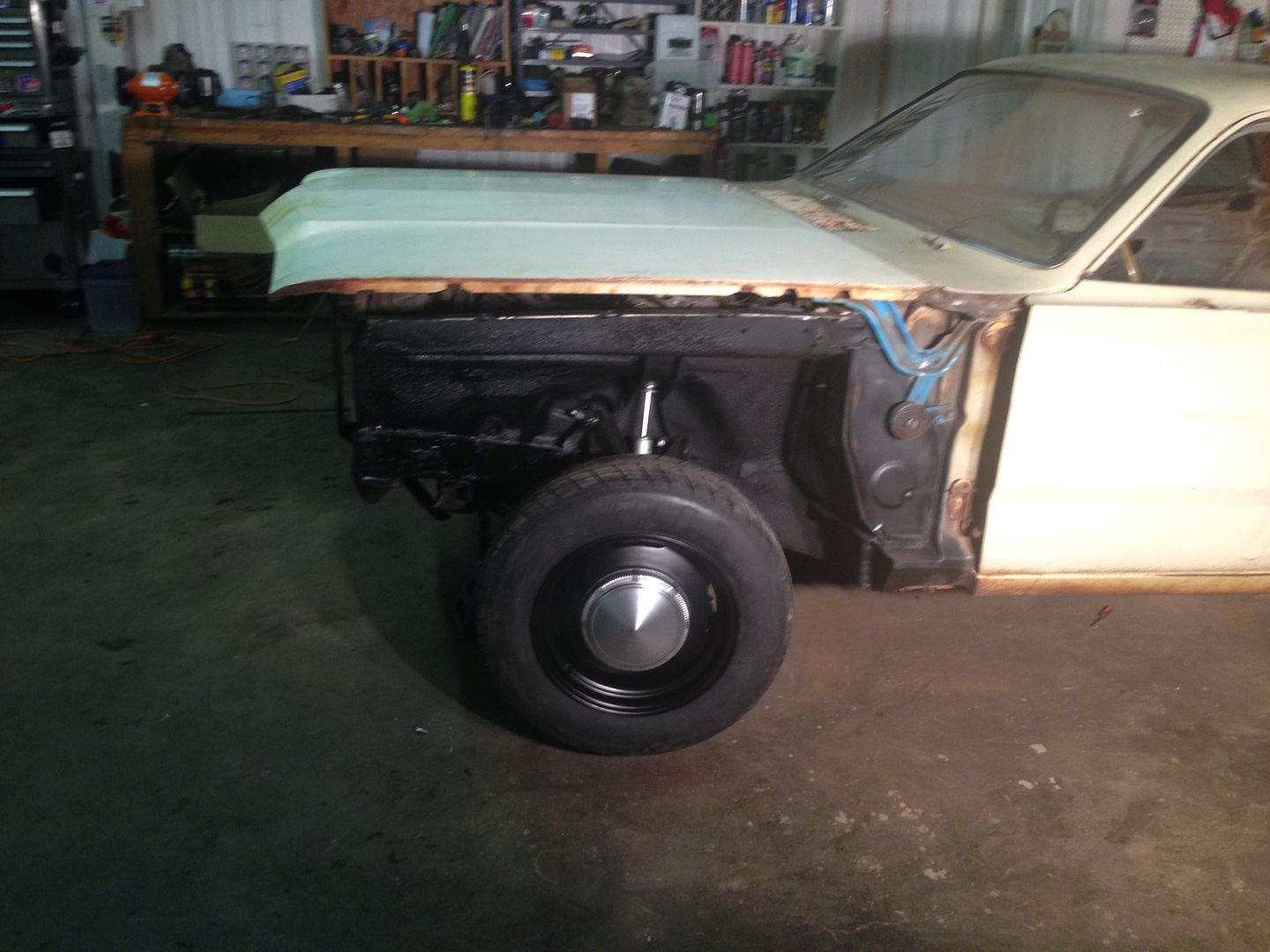

Here we are starting to hang our fenders.
Now it looks like a car! We did not fit the new panels, as the frame shop instructed us not to as they would do that when they straighten the frame.

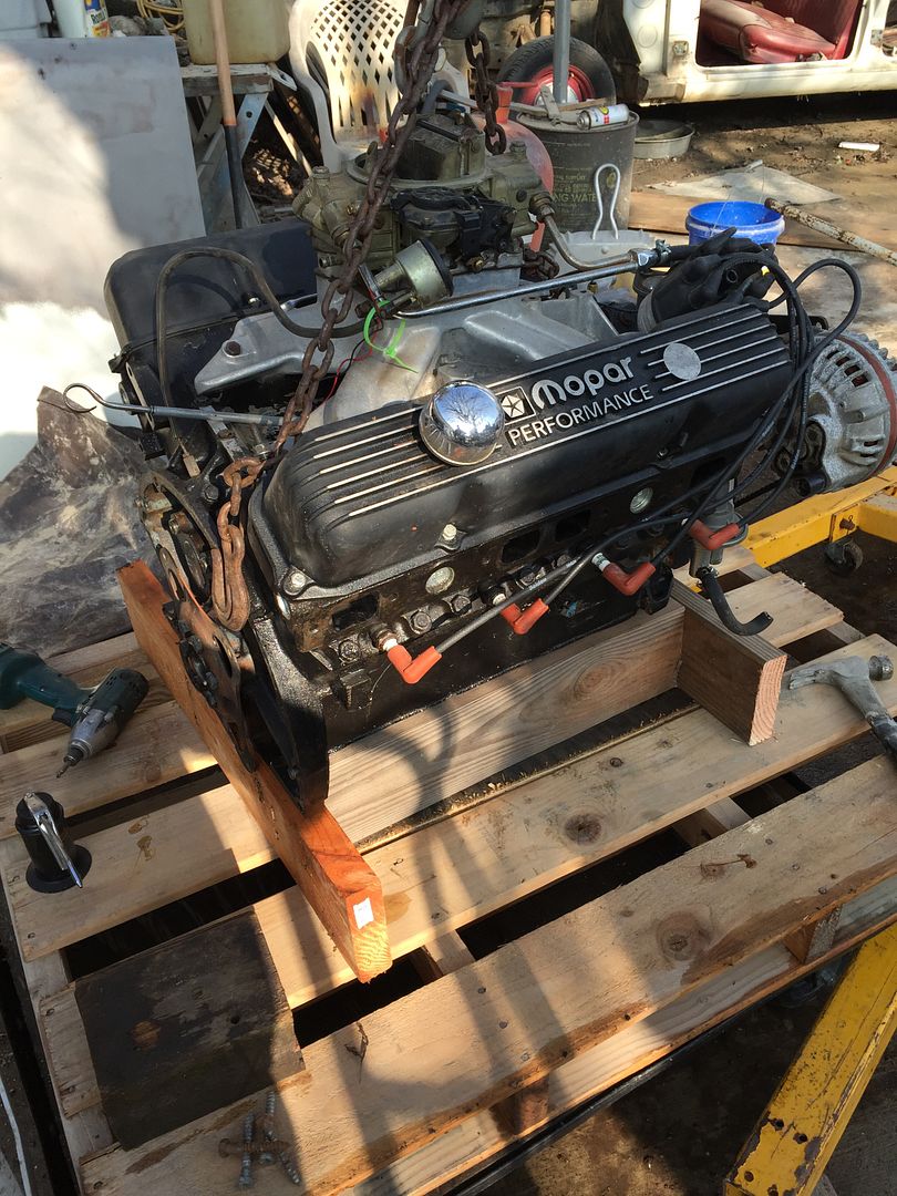

Ordering my new gears and rebuild kit today for the Dana we are installing. Can't wait to see it on the SS springs. I also have an advancement in the engine department as I ended up purchasing a 383 stroked to a 426.
This should be a good engine to install for the season and give me more time to build the 400 block. It worked out great since both are B blocks and when I swap latter down the road I won't have to do any additional modifications.

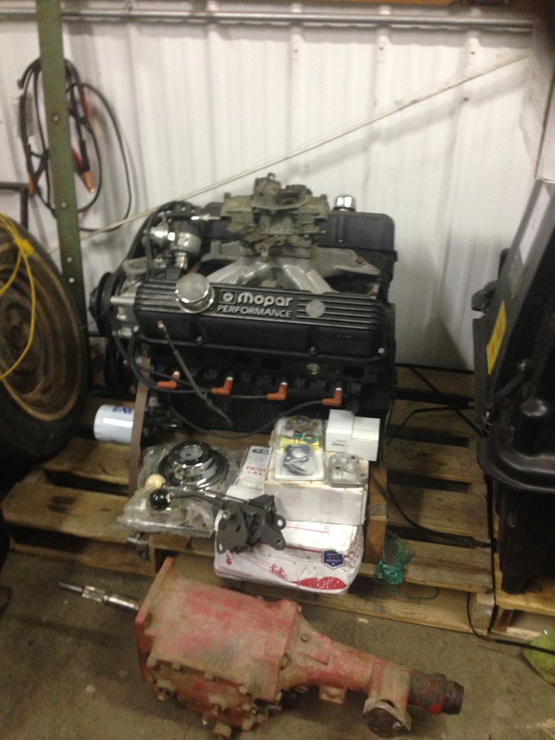

Thanks! I have always loved the look of steel wheels and caps. I can't wait to get it to the point of paint. I picked up my 4 speed tonight so my drivetrain is now complete. I also got my clutch and 6 pack intake. My friend who owns the shop next to me is rebuilding the carbs right now.

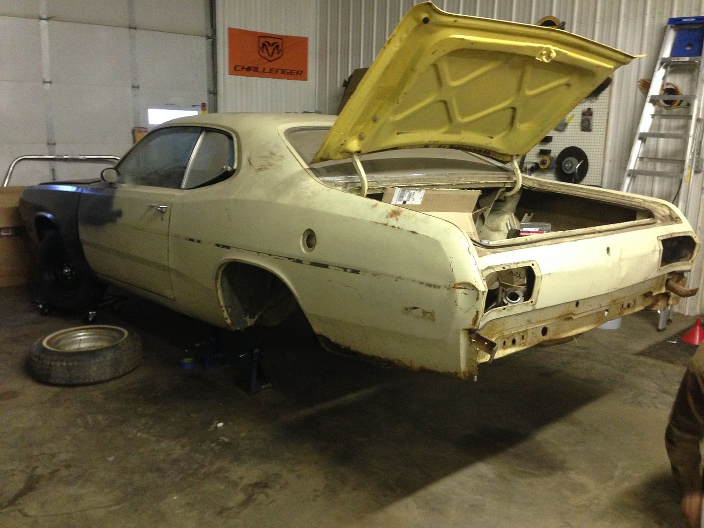

Well as always life gets in the way and I did not have much progress for a good part of the spring and summer due to work. I finally got back after it and got my Dana installed with SS springs and brought the duster to the frame shop.

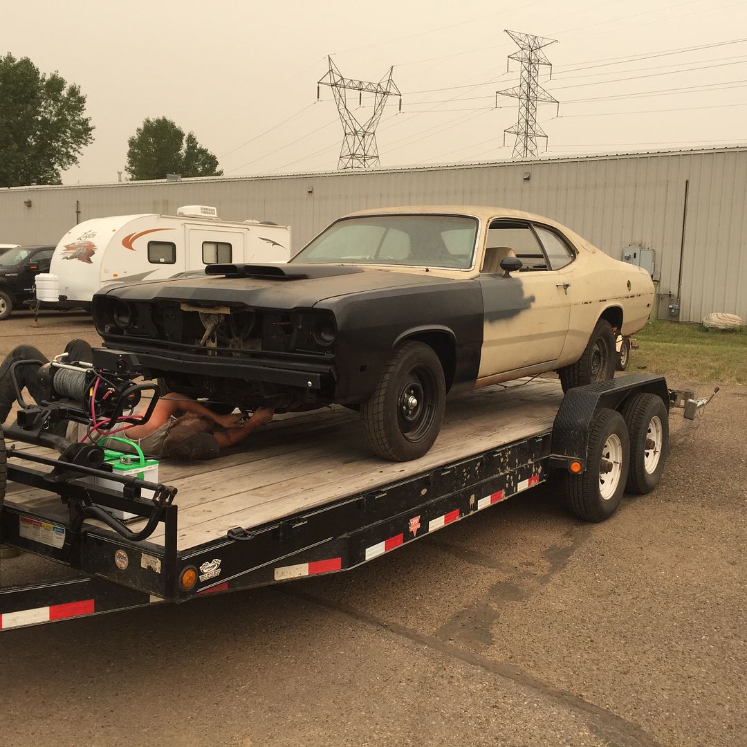

Here she is rolled out of the shop to go to the frame shop.
All loaded up.
While she was at the shop I have been working on my Hurst
Today the shop called and back we went to get the Duster. They did a great job and lined up the body panels well and set the torsion bars up for me.
I also brought it by the body shop today and scheduled her to be dropped off in November. So now it is time to fit my roll cage, 383, and 4 speed to get everything fitting right before the final body work.
