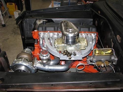

But, but, but... he already HAS the slant six; with the Magnum motor, he has to buy EVERYTHING, engine, transmission, etc... and a new ring and pinion; he already has a 2.76:1 ring and pinion installed; that and the 518's OD will give him a final drive ratio of 1.90;1.... too tall. A 2.76 is perfect for the slant six motor, both drag strip and higway. Both Ryan Peterson's and Tom Wolfe's kickass slant cars run the 2.76 ratio on the drag strip and say it works better than a 4.10.
Money saved...
By the time he's through swappping V8 stuff into this chassis, I'll bet it will be more expensive than turboing the slant six he already has.. plus, a V8 is so commonplace, whereas a turbocharged slant six is unusual,,, Maybe a plus, maybe not.
Just my 2-cents (and, probably overpriced, at that...):blob:
EBAY!
$15.00 w/ free shipping
It is very similar to a spectre but shorter. It works fine and it's well made.
http://www.ebay.com/itm/4-6-W-COLD-...r_Truck_Parts_Accessories&hash=item540ead588d
ALso they have blue and red ones somewhere. I just like the black ones because when they get dirty they still look black. I'm thinking of extending the intake of the turbo up to the rad support, and putting a through hull on it - then putting the filter behind the grill in front of the rad support.
