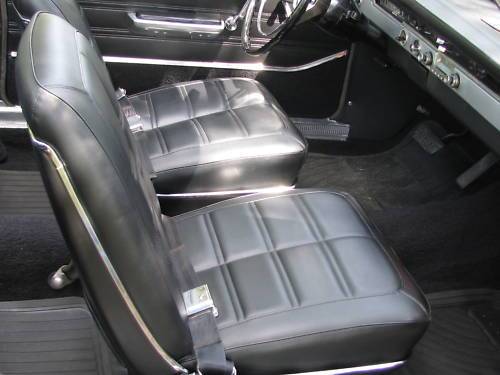

You might be missing the sill plates
You can see them (2 pieces per side) in this pic if you look closely
left pic has the outer (just a 90 degree bent plate) and the right pic shoes the shaped piece that goes on the inside to hold the carpet and cover wires and Windlace. I can take a pic of them out of the vehicle later tonight after I get off work.

Thank you very much. I'm missing the inner still plate cover in the second picture. The other 90 degree bent plate I have, but not the other. Now I have to search around to find a good set. Would be helpful if you could take the pictures out of the car or closer up. Thanks again.

here they are
What you need are called carpet holdowns.
Layson's has nice reproductions available.
And I have a used set if you don't want new.
My lord,..when I purchased the car the trunk had a lot of parts in it and I put them in my basement. I went down to the basement last night and sure enough there was the the carpet holddowns!! At least I have them. Thanks again for the help. I hate getting old,...I forget things I do sometimes and what I have in parts,..LOL.
