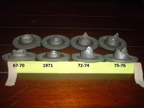

Not sure this will help either, but at least it shows the type of cap you're looking for...
