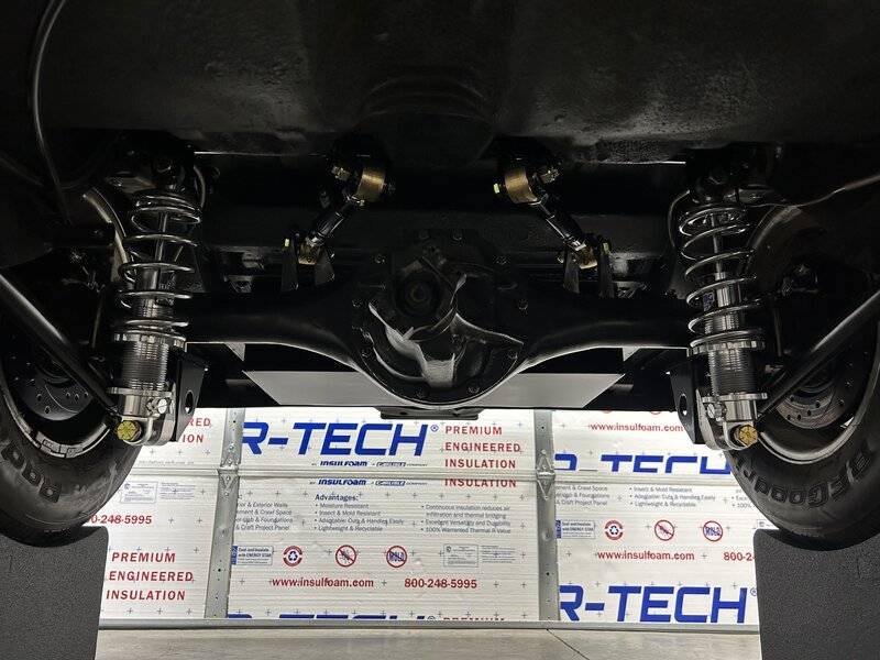

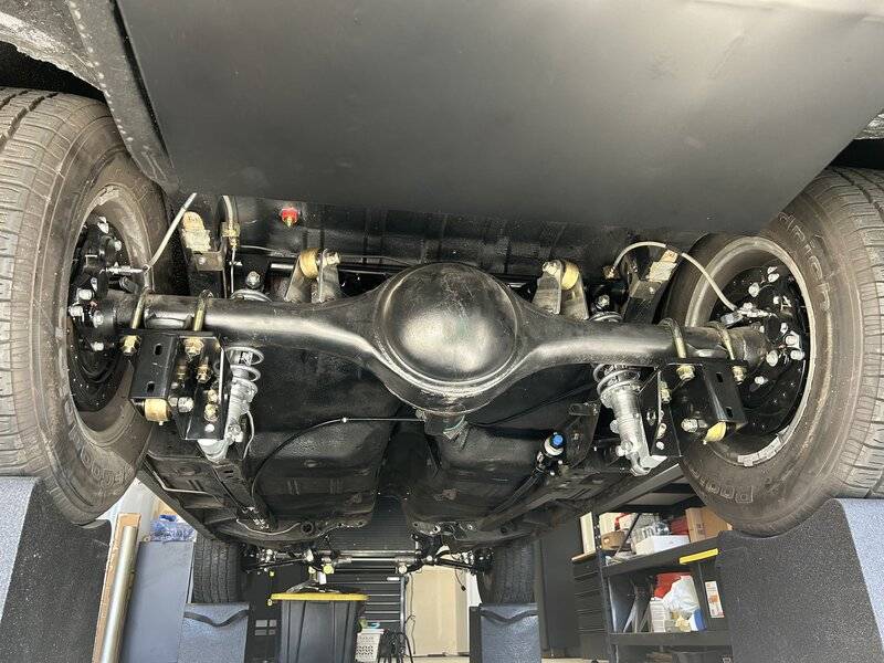

Installed the RMS 4 link rear in my 65 valiant and I had to adjust the passenger side strut up an inch more than the drivers side to get the same height from side to side. The passenger side is nearly maxed out. This can’t be right, links are all within an 1/4”
With both struts adjusted equally the passenger side sits 1/2” low. I do remember with leaf springs it sat lower on the passenger side but don’t think I ever measured it.

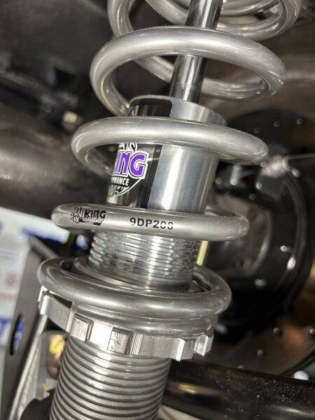

I think you have 2 different springs. One looks like 4 full turns and the other is 5.
Are the parts numbers on the springs the same? Did they have the same length sitting on your bench prior to installation? Something's not right.

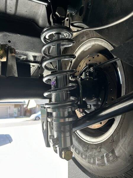

I think it’s just the way the spring was clocked on the strut. Here’s a recent photo with them adjusted the same. Also they have the same part number.
Something's up with that passenger side spring would be my guess. The angle of the coils seems very different

Your drivetrain is offset to the passenger side so there will be more weight on the passenger side requiring more pre-load. However, lowering / raising the height on the drivers side front (torsion bar or coil over spring) will also effect the height of the passenger rear.
Welcome to 4-bar 101
What Denny says. This was a head scratcher for me also when I built my triangulated 4 link. My passenger side was lower but after I got the front squared with the t-bars it leveled out. But I have to say that yours looks a little extreme with the coilover jacked up that far and you’re still not able to level it out.
