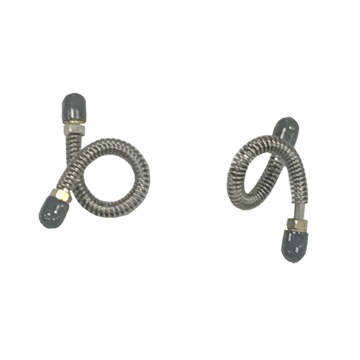

Am working on my 1970 duster brakes. On front, have 10" drums and am trying to provision the small "squiggly" hard line that goes between the soft line & wheel cylinder. Anyone had any luck finding these? Google didn't yield any success.
Back when I still had drums I went to the parts store and bought the shortest pre made lines with the right fittings and coiled them up
try inline tube, looks lik a you have the 9" drum line installed! Just saying incase there 9" and not 10"
10" drum
9"drum
Hello again everyone. Does anyone have photos of how the 10" drums connect between the wheel cylinder and the soft/flex line? Thank you.
To close the loop on this I ordered from inline tube and the 9" lines aren't going to work. Fortunately Inline Tube has offered to custom make the ones I need for me. Posting so that if anyone else runs into this they know at least one possible solution.
