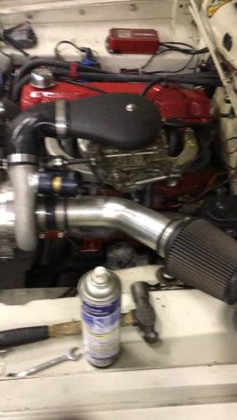

Started it tonight. I haven’t got the Holley sniper yet. I really think the sniper will resolve lots of minor issues with fuel system

And you are utilizing a Torkstorm unit? How is clearance for fan or alternator?
