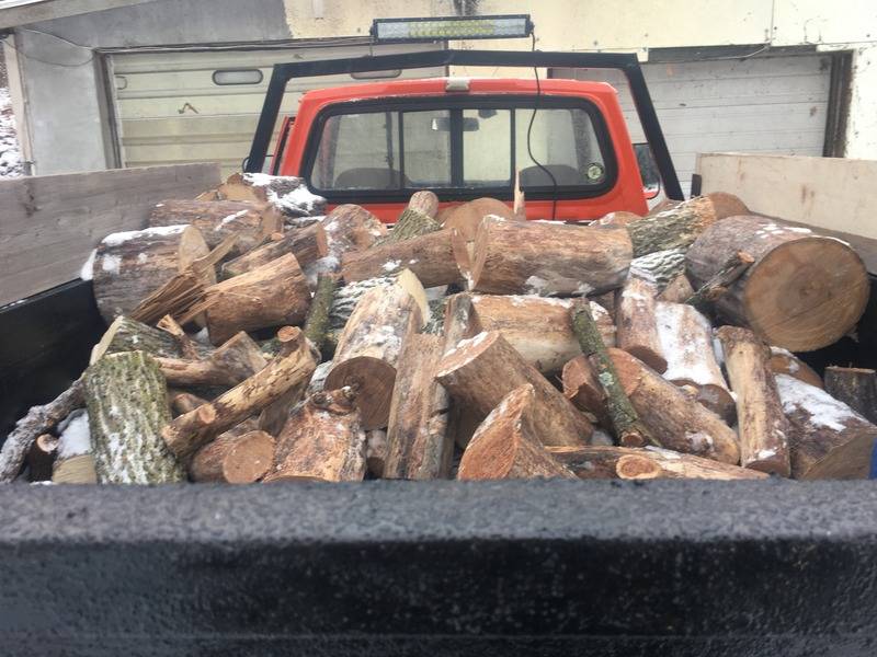

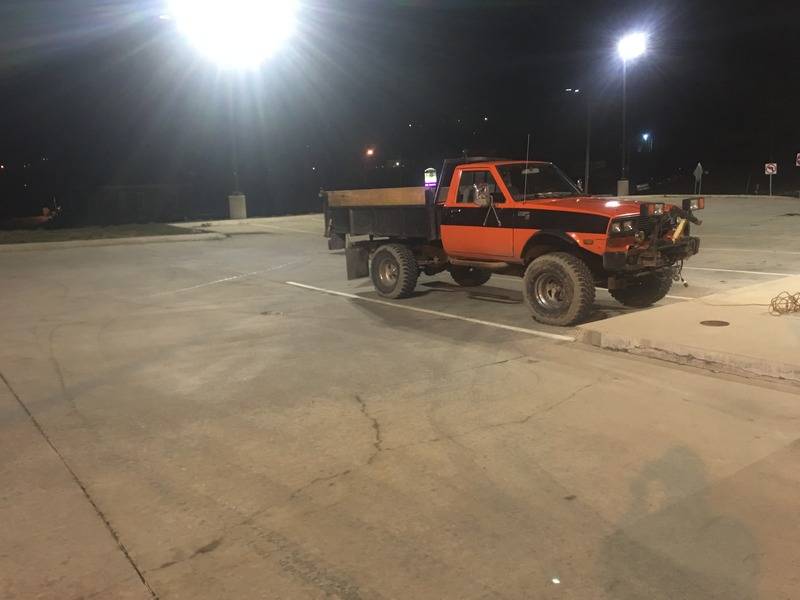

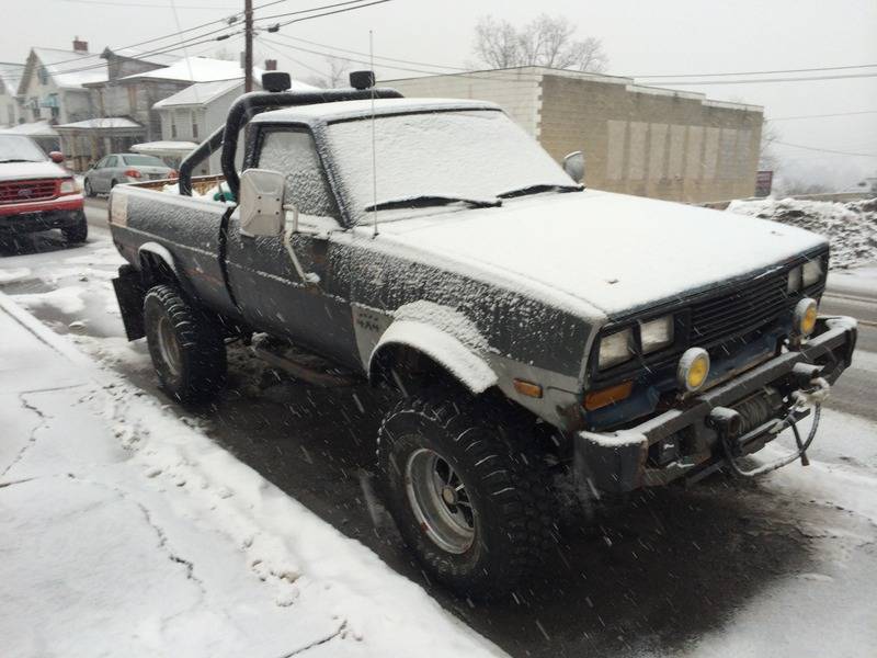

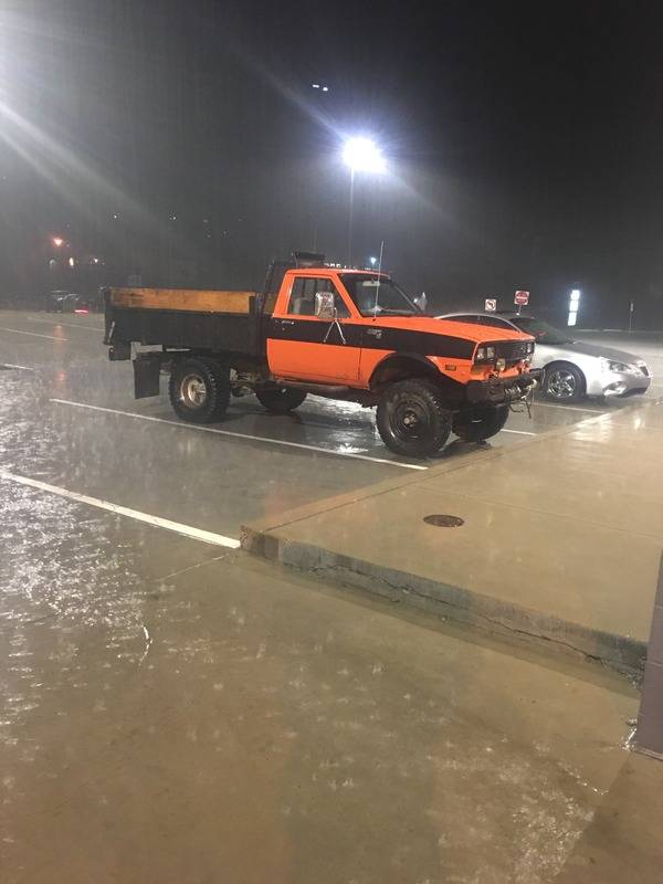

Here's a little 273, with a whole lot of vehicle around it. She sits in a highly modified '84 Dodge D50 4x4. The truck in question runs a fullsize W100 Frame, Solid Axle Swap (Dana 44 up front) and a B-Body 8-3/4" Sure Grip in the rear with 4.10's, a KM100/NP203 Transfer Case Doubler (she's AWD/Fulltime 4WD), a 727 with a TF2 Shift Kit. She sits on 33" Tires with 3/4 Ton springs in the front and 1-1/4 Ton Ambulance springs in the rear
She's fitted with 2" Tube Bumpers (.250" Wall) with front & rear winch cradles (has a 10k on the front and I pulled the 12k from the rear so I wasn't welding around it when I built the hinges for the bed), and the front bumper is equipped with a Meyers Quick Connect Snow Plow Mount.
The Bed is a 9.5' Dumpbed, 2" Tube Structure, the sheeting for the sides/floor is repurposed scrap train car that was bought from the scrapyard years ago. My dad and I built the dumpbed about 18 years ago (it's where I learned to weld)
The little truck is no slouch with the 273, even with all the weight. It's pretty good about burning all 4 tires if I get into the throttle hard. Of course the 273 isn't stock either. She's bored .060, with Forged Domed Pistons, 1.88 Valve J Heads (Milled), a 340 Intake with a 650 Eddy on top (did have a 850 Thermoquad on it, but I needed it for my car), a 495/505 Isky Solid Cam, Forged Crank, H Beam Rods, 11.1:1 Compression. It gets pretty good mileage (high teens), as long as it's not fully loaded. I use the little monster as a daily driver.

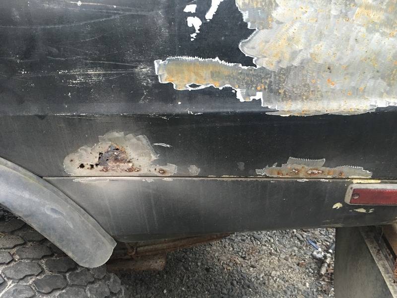

It started out looking like this (A few years ago). That pickup bed was a Rust Free Southern bed off an '83 2wd...

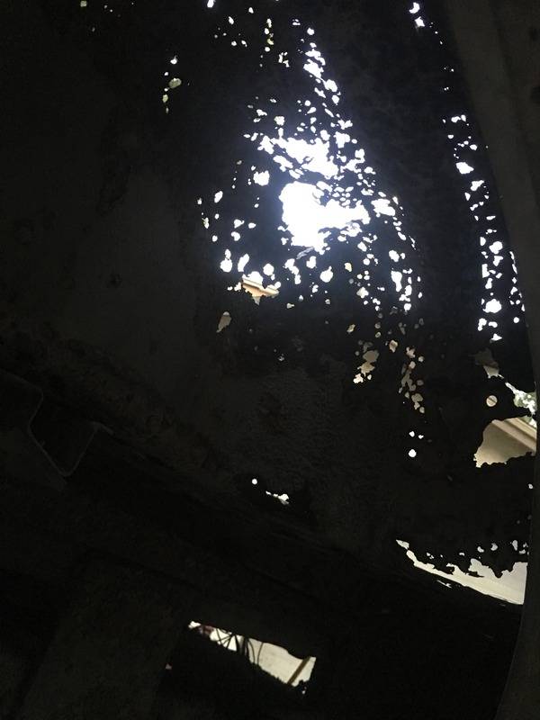

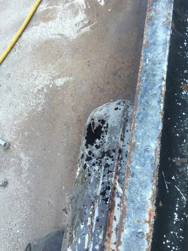

That same bed spent 3 years exposed to the crap they spray on the roads in PA and it looked like this.
image_zpsq0rtsels.jpe
image_zpsric1nfbr.jpe
image_zpsyusbmvub.jpe
Also the Passenger side Door (from the same southern truck) fell off when I opened it on December 23rd.

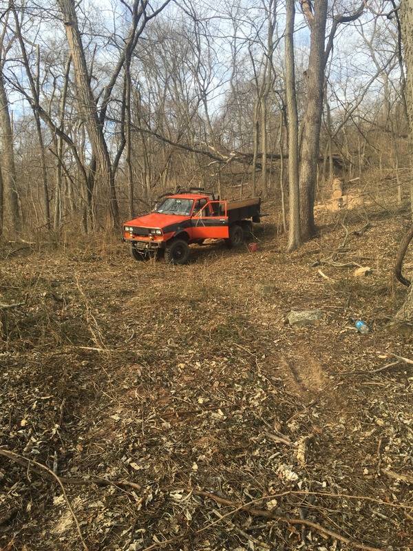

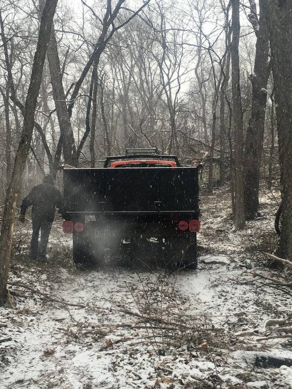

In roughly 24 Hours it transformed into a nice truck again, thanks to help from my friends. Oh yeah, it's got a pretty ridiculous amount of lift too. Lifted makes it pretty nice taking it up 1800's stone quarry trails to get firewood, thats some rough terrain at times

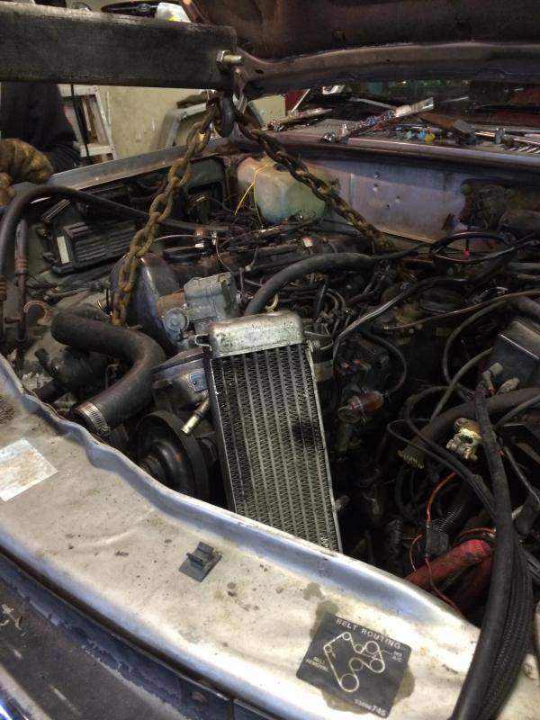

My '92 D50 daily driver, she's fitted with an M90 Supercharger, Eclipse/Laser Turbo ECU, 4.22 Gears with an Electric Locker in the rear axle, 5" of lift, 32" tires.
I picked her up for $190, fixed a few things, modified a few things (it was stock when I bought it). Little creature gets an amazing 22-24mpg

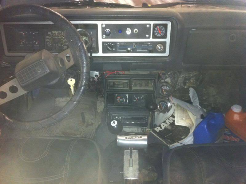

Oh yeah, the Electric Locker in my '92 D50 was a factory option. My little 92 was ordered with the Sport package (Cargo Light, Power Antenna, Stripes (I removed them, they were peeling), 4 Speed Delay Wipers. It was also ordered with the "Winter Package" which came with 4.22 Gears (I wish it would have got the optional 4.65's or 4.89's), a factory Electric Locker, HD Torsion Bars, and the HD V5MT1 5 Speed instead of the weak KM145 5 Speed.
Got a handy little switch to the right of the steering column to lock/unlock the rear axle
